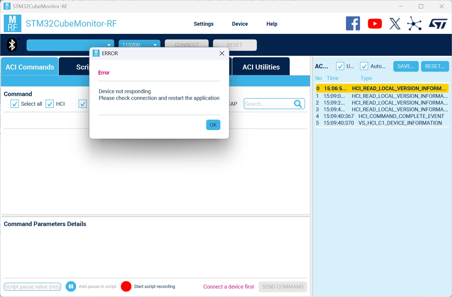

I tried building and flashing the sample project BLE_TransparentMode to verify Direct Test Mode on the Nucleo-WBA25CE1, but it doesn't work properly.
When I connect using STM32CubeMonitor-RF, an error pops up and the application terminates.
Sending 0x93, 0x94 (TX, 2440 MHz, PRBS9) from the terminal yields no response.

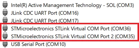

Two COM ports appear, but connecting to either one results in the same outcome.
How can I enable Direct Test Mode?

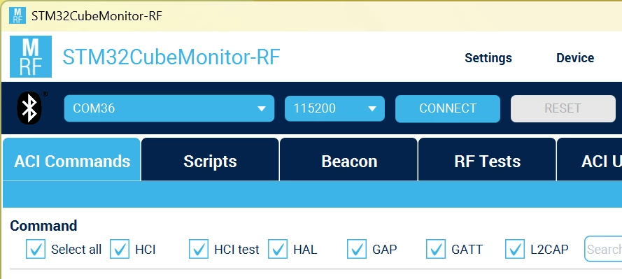

Make sure to select the correct COM port and baud rate.
I recommend this guide which explains the steps to connect your device to the STM32CubeMonitor-RF tool:
gocchan
gocchanAuthor
Senior
Jun 19, 2026 6:49 AM UTC
When I connect the board, two COM ports appear. I've tried both, but neither works.

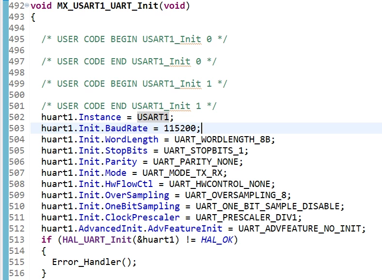

I'm using the BLE_TransparentMode project, and the source code seems to be set to 115200 bps, but when I connect with CubeMonitor-RF, an error dialog appears.
Changing the Baud Rate doesn't help.
However, only when I set COM36 and 115200 does two error dialogs appear, and the application is forcibly closed.
