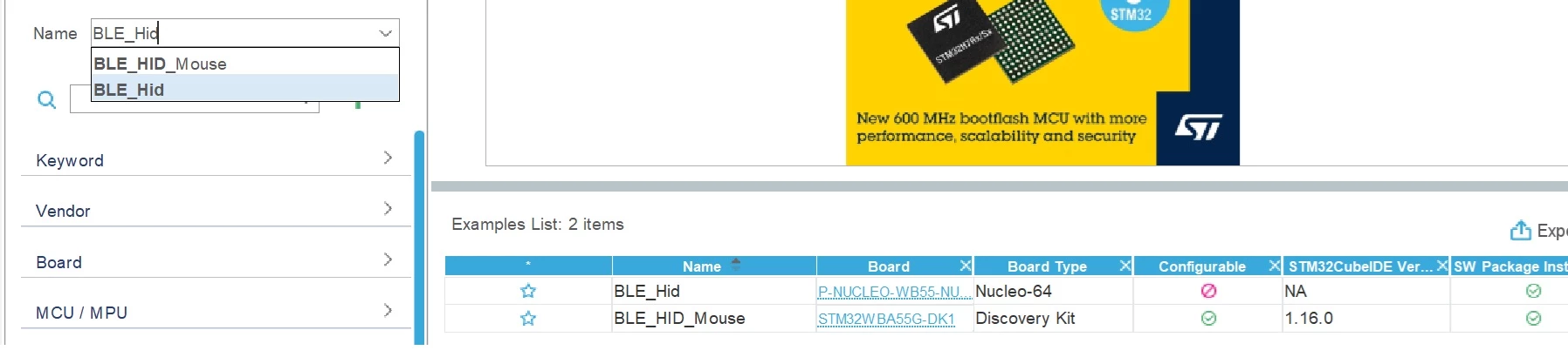

NUCLEO-WB55RG with BLE_HID_Mouse example not connecting.
After flashing NUCLEO-WB55RG board with the executable file from BLE_HID_Mouse example
can't pair the board with the BLE of a computer. Add a device - does not see it!
I have LMP 11.2292 - Bluetooth 5.2
What should I do?
Also, in BLE_HID mouse example README.md I did not find - how SW1, SW2 and SW3 are assigned to joystick!

Dear @GS2 ,
At first glance, it sounds like you are trying to run an example on the wrong board.
Please, can you clarify where did you find this BLE_HID_Mouse example?
Because, on NUCLEO-WB55RG the example is called BLE_HID (without "MOUSE") and the readme file is .txt not .md
Moreover, you are talking about joystick, which indeed doesn't exist on NUCLEO-WB55RG.
Thus, my assumption is that you are trying to run BLE_HID_Mouse example made for board STM32WBA55G-DK1 (where a joystick is implemented).
Best Regards,
Alan Porte
ST MCU Support Team

Jul 3, 2024 1:51 PM UTC
Thank you Alan,
Yes, you are right, I can see STM32WBA55CGUX_FLASH in my example.
But there were only 2 BLE_HID examples for my P-NUCLEO-WB55RG board available.
HID_BLE_Examples.jpgThat why I picked BLE_HID_Mouse, because BLE_HID is not configurable and there is NA STM32CubeIDE version available for it! So what is your suggestion on how to solve this problem?

Hello @GS2
As said @Alan PORTE and as I've said me and @Andrew Neil on your previous post, The BLE_HID_Mouse is designed to work on the STM32WBA and specially for the Discovery Board. It is not fully compatible with the STM32WB which is a different series (STM32WBA is not the STM32WB). So, you can't run the BLE_HID_Mouse example on an STM32WB and expect it to perfectly work since there is a difference between both series. Also, for the BLE_HID example, you can run and compile it on the STM32CubeIDE. It is just not based on any .ioc file but write directly to the IDE without CubeMX initialization. So you can use it on the CubeIDE (the picture you shared means that it can work on all CubeIDE versions).
Best Regards.
