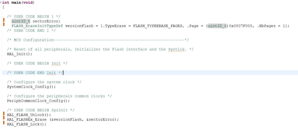

Nucleo-WB55RG / CubeMX / Flash Erase Hard Fault Interrupt??
I am using the above subject Nucleo.  I create a project and let STM32CubeIDE V 1.16.1 create a default project.  I make NO changes to this.  I close the .ioc and open main and add the following code (seen by Red Bars).  I build and load to target.  I place a breakpoint on the HAL_FLASHEx_ERASE function and when I go to step over this function I get a hard fault interrupt.  I step into code and the following line
 MODIFY_REG(FLASH->CR, FLASH_CR_PNB, ((Page << FLASH_CR_PNB_Pos) | FLASH_CR_PER | FLASH_CR_STRT));
creates the hard fault.  Can someone please tell me what I am doing wrong here?....The target address has been verified to be readable via STM32CubeProgrammer so I know that it is not out of memory space.

In FLASH_EraseInitTypeDef versionFlash Page field you're passing the absolute flash address, while page number is expected.
FLASH_EraseProgram example project is using GetPage function for page calculation to pass into Page
static uint32_t GetPage(uint32_t Addr)
 return (Addr - FLASH_BASE) / FLASH_PAGE_SIZE;

Thank you...Yes I found this over the weekend.
