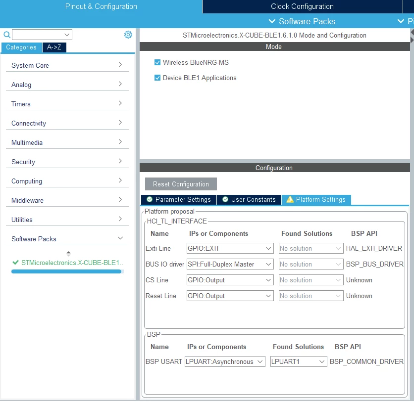

Hello everyone,
I'm trying to create a BLE project as virtualCOMPort to start and after saving the setup wizard, when it compiles I get an undefined reference to `MX_BlueNRG_MS_Init and MX_BlueNRG_MS_Process'.
This functions are declared inside 'app_bluenrg_ms.c' thats appear in the folder group.
What could be wrong?
I join the screenshot on settings and error.
Thank you

Hi @JSanz.1​ ,
I have checked your ioc file, you need to select both Device X-Nucleo-IDB05A1 and WirelessBlueNRG-MS (configure it throught CubeMX interface), and it will be OK without errors.
It will be better if you use the latest version of CubeMX with the X-CUBE-BLE1 6.1.0 version.
Best Regards,
Khouloud

Hi Khouloud,
As you suggested, I upgrade to the X-CUBE-BLE1 6.1.0 version.
I have checked both checks, one match to the WirelessBlueNRG-MS but I can't find the X-Nucleo-IDB05A1 and I supposed it should be the Device BLE1 Applications.
In the Platform Settings there appear a HCI_TL_INTERFACE that seems as if the BLE CPU2 needs to connect to Process CPU1 via external pins, becose there are no option to modifie.
Initially I thought that both CPUs were visible to each other, by internal shared resources.
Probably I misunderstood how it work.
I've joined a screen capture.
Thanks for your help

hi @JSanz.1​ ,
Yes, only the naming has been changed ( and some issues has been fixed).
Otherwise , you need to configure Platform settings to avoid any risk of problem.
Best Regards,
Khouloud
