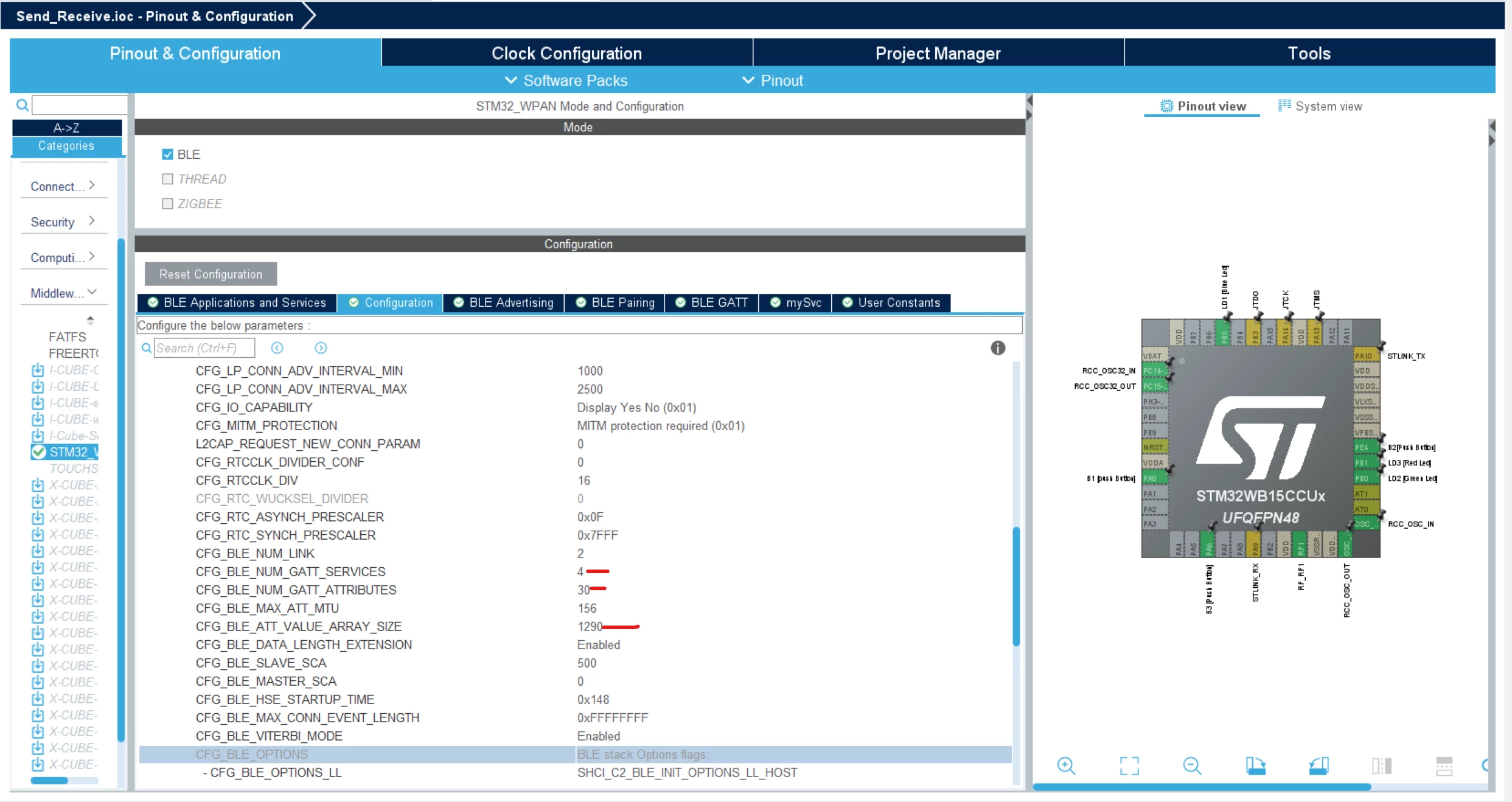

I am currently doing the tutorial from ST (STM32WB Getting Started Series: Part 12b, Lab. Receiving data from the phone) to send and receive Information with BLE. I am stuck in the video at 15:00 when the device should show up on the ST BLE Toolbox App. (Some clock settings were not right from the beginning, I adjusted them to the ones in the video)
I already tried:
  • repeating the tutorial in case I made any mistakes
  • replacing the services, attributes and array size (was already correct due to latest update), see picture in attachement
  • resetting the nucleo after flashing
  • replacing my app_ble.c and custom_app.c from the google drive (not the ble_conf.h as this has the settings for the WB55)
  • the heart rate example. It works and shows up. replacing the settings from me with the ones from this example (BD_ADDRESS and Power didnt help.

So first I would check following points:
Is the stack up to date?
Do use string to float conversion or vice versa, if yes comment them temporarily out
Double check in the header if code generator set the correct values
CFG_BLE_ATT_VALUE_ARRAY_SIZE = 1290
CFG_BLE_NUM_GATT_ATTRIBUTES = 30
CFG_BLE_NUM_GATT_SERVICES = 4
if ​this doesn't work, use the debugger pause after a few second and see if you trigger an error handler, there you can get the most recent error code returning information why there is no advertising

It was the Stack that needed upgrading. I had to do the full extended stack upgrade (../STM32Cube_FW_WB_V1.16.0\Projects\STM32WB_Copro_Wireless_Binaries\STM32WB1x\stm32wb1x_BLE_Stack_full_extended_fw.bin)
How to do it is explained in the youtube video: STM32WB Getting Started Series: Part 9, STM32WB FUS update
