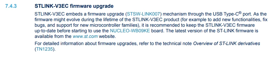

the problem could be linked to the ST-Link V3 firmware on the NUCLEO-WB09KE board.
To resolve this, I recommend upgrading the firmware of your ST-Link V3. You can do this by following these steps:
  1. Download the STSW-LINK007 Utility: Visit the STSW-LINK007 page on the STMicroelectronics website.
  2. Install the Utility: Follow the instructions on the website to install the STSW-LINK007 utility.
  3. Upgrade the Firmware:
    • Connect your NUCLEO-WB09KE board to your computer using a USB cable.
    • Launch the STSW-LINK007 utility.
    • Follow the on-screen instructions to upgrade the firmware of your ST-Link V3.
After upgrading the firmware, reconnect your NUCLEO-WB09KE board and check if the issue is resolved.
If you need further assistance, feel free to ask!
more information can be found in the UM :

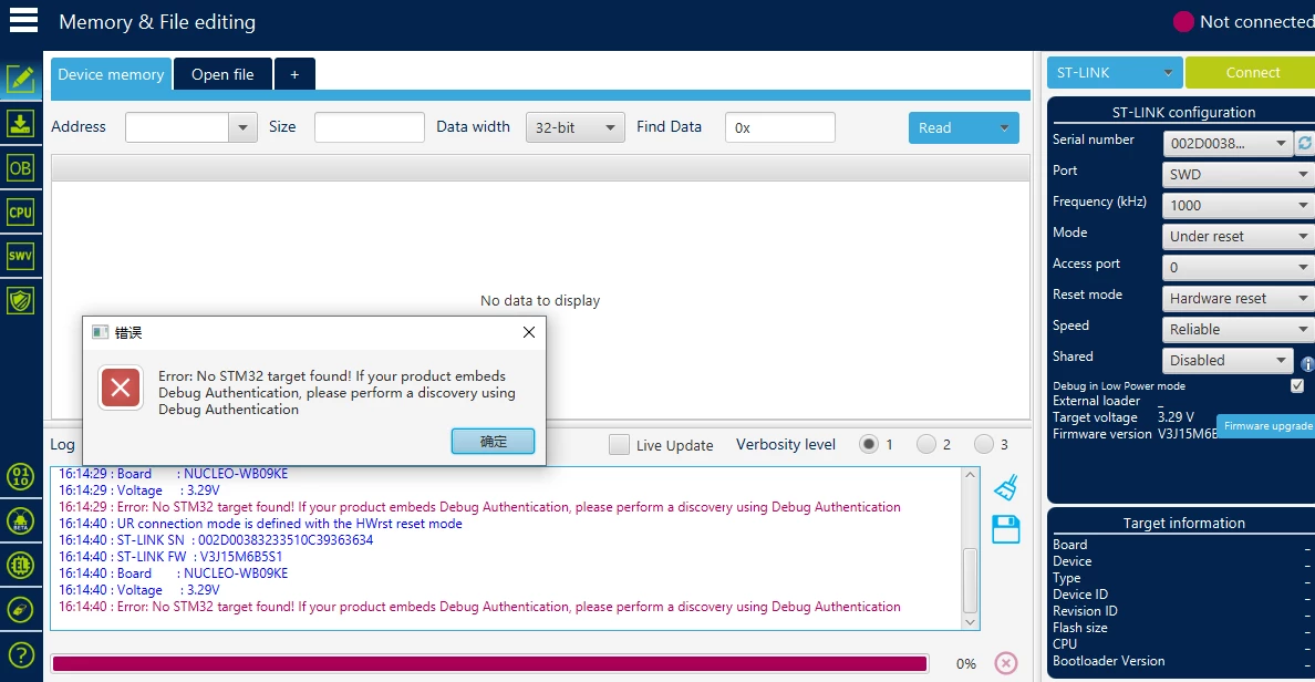

I have already upgraded st linkv3,but Before and after upgrading again,I still can't connect tommexport1727687909892.png the NUCLEO-WB09KE

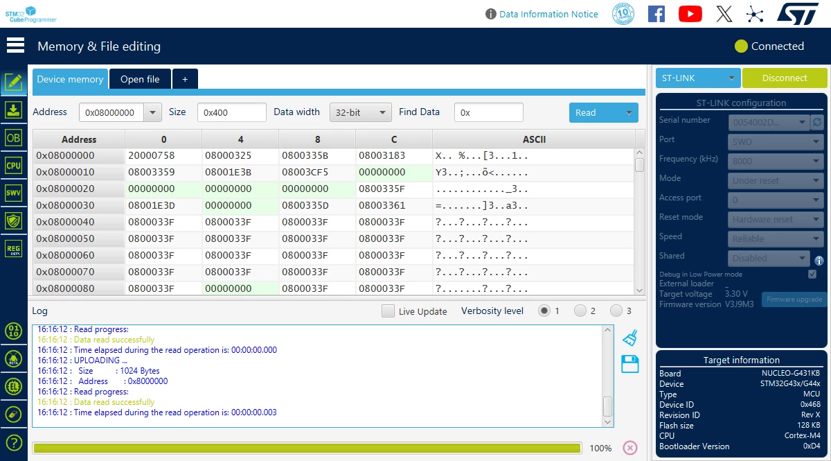

My other boards can connect and recognize normally

have you updated the stm32cubeprogrammer program? which version are you using?
DvacosAuthor
Sep 30, 2024 9:36 AM UTC
stm32cubeprogrammer,It is the latest version on the official website

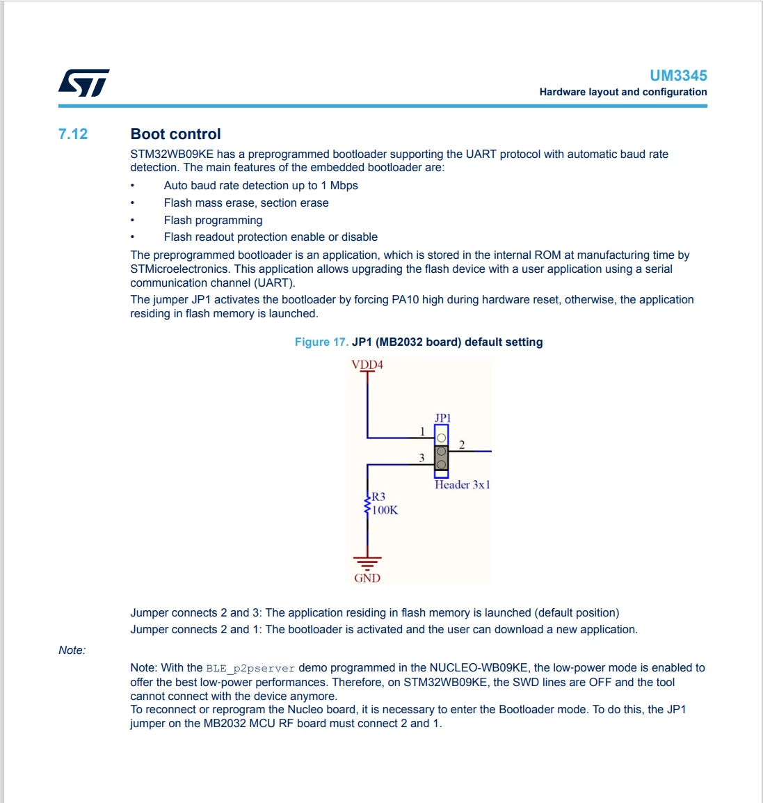

For your information, the application, which is programmed during production, activates the low-power mode, so the SWD port is no longer accessible after the board is booted. You therefore need to follow the UM of this board, see below for a screenshot of the UM.

I have reviewed this document,
1. I pulled up the boot, ST link v3, but still generated a fail. txt file
2. I configured the program to enable SWD, but even after pulling up the boot and downloading it, it still generates a fail. txt file
Sep 30, 2024 9:58 AM UTC
I can see from your screenshot that the stlink version you used is not the most recent version available on the ST website. Can you use the link above? you will need the latest version of the stlink utility: 3.15.7
