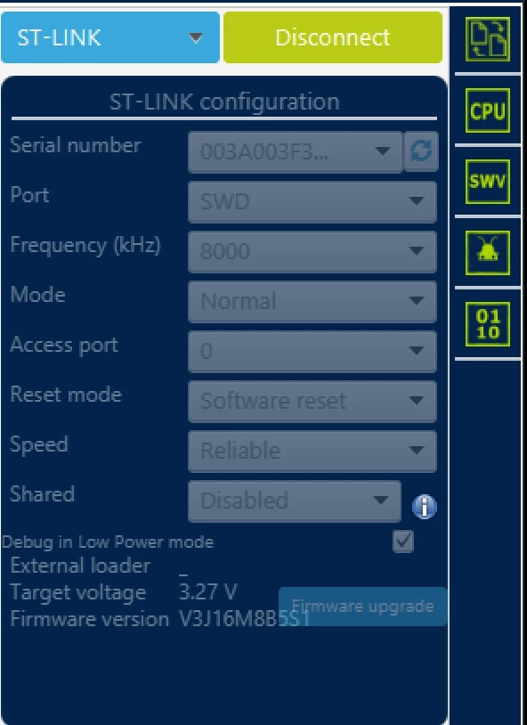

AralebAuthor
Sep 7, 2025 6:12 AM UTC
Thanks so much, it works perfect.
Please note that before erasing, one must return to ST-LINK PORT: SWD
Additionally, I would like to upload BLE_p2pServer in debug mode, but it does not appear to be working. What shall I do to upload and play with it to adapt it to my requirements?
