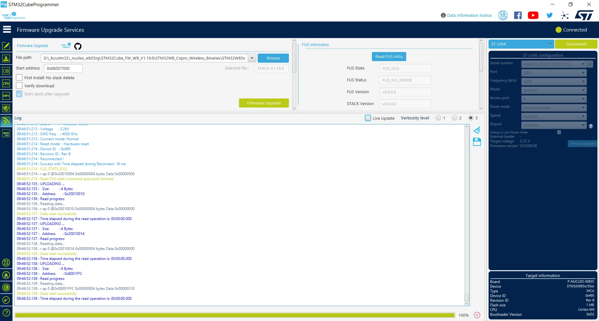

Start FUS: works
Read FUS info: works (see screenshot)
Neither firmware deleting nor Firmware upgrading is possible with my STM32WB55 Nucleo board.
Always receiving FUS_STATE_ERR_UNKNOWN.
Can you please advise how to proceed?

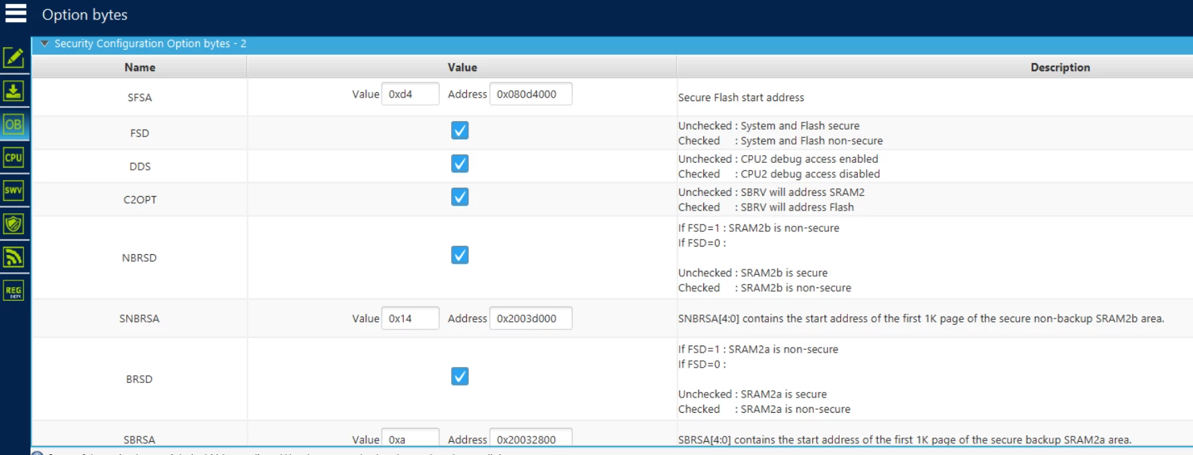

Below you can find the option bytes of the board:

OPTION BYTES BANK: 1
Security Configuration Option bytes - 2:
SFSA : 0xD4 (0x80D4000)
FSD : 0x1 (System and Flash non-secure)
DDS : 0x1 (CPU2 debug access disabled)
C2OPT : 0x1 (SBRV will address Flash)
NBRSD : 0x1 (SRAM2b is non-secure)
SNBRSA : 0x14 (0x2003D000)
BRSD : 0x1 (SRAM2a is non-secure)
SBRSA : 0xA (0x20032800)
SBRV : 0x3D800 (0x20000000)

STTwo-32
June 4, 2024
Hello @Rena Z.
According to your screenshot, SBRV is equal to 0x3D800 that indicate FUS v0.5.3 is running on your board. So, you must update the FUS using the stm32wb5x_FUS_fw_for_fus_0_5_3.bin binary.
Best Regards.

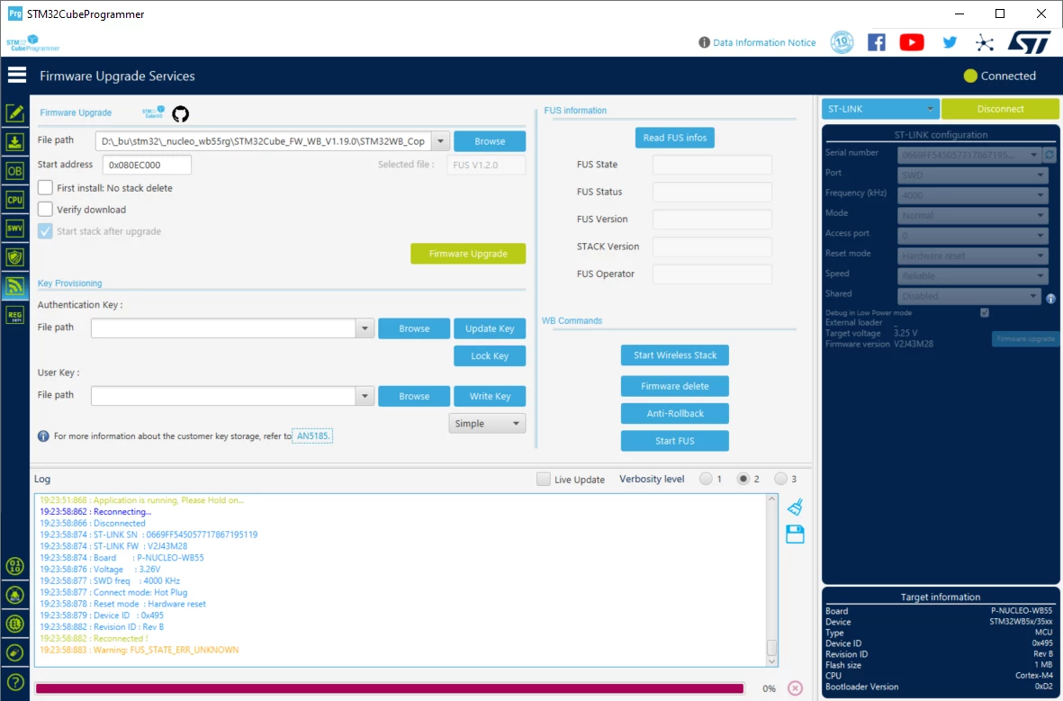

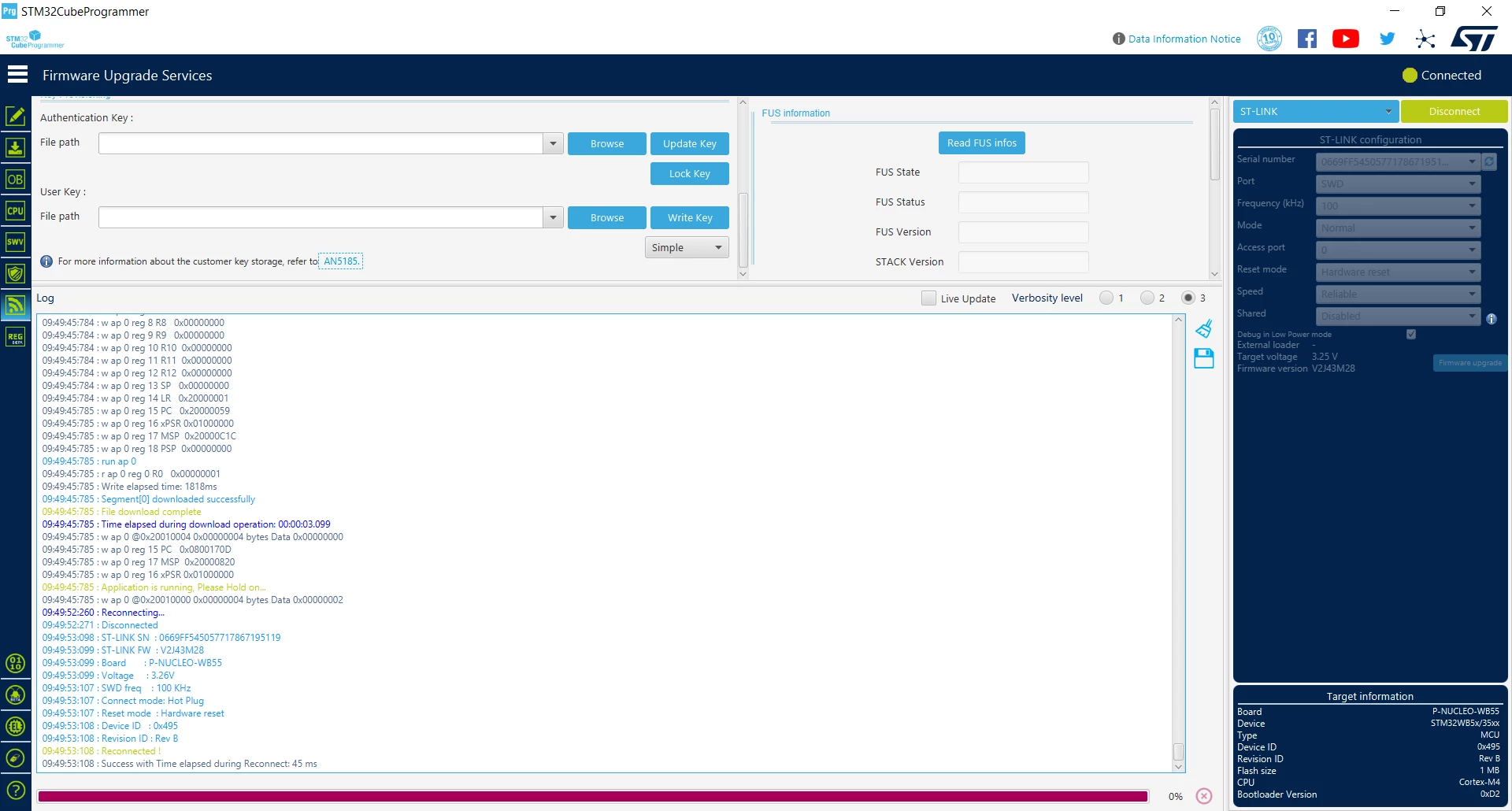

Hi @STTwo-32 ,
thanks for the quick response. Sorry, but you may haven't fully read my post "Neither firmware deleting nor Firmware upgrading is possible". I tried updating with STM32CubeProgrammer GUI:
and also with the CLI tool (see below). Seems that uploading (1.step of FUS) works but starting the firmware (2.step of FUS) always fails with FUS_STATE_ERR_UNKNOWN.

ST-LINK SN : 0669FF545057717867195119
ST-LINK FW : V2J43M28
Board : P-NUCLEO-WB55
Voltage : 3.26V
SWD freq : 4000 KHz
Connect mode: Hot Plug
Reset mode : Software reset
Device ID : 0x495
Revision ID : Rev B
Reconnected !
Error: FUS_STATE_ERR_UNKNOWN: Unknown error
Error: fwupgrade Command Failure!
STTwo-32
June 13, 2024
Hello @Rena Z.
When it fails on the first time on the firmware starting, can you try again by clicking on the "Start FUS" Button. It may fail on the first time.
Best Regards.
