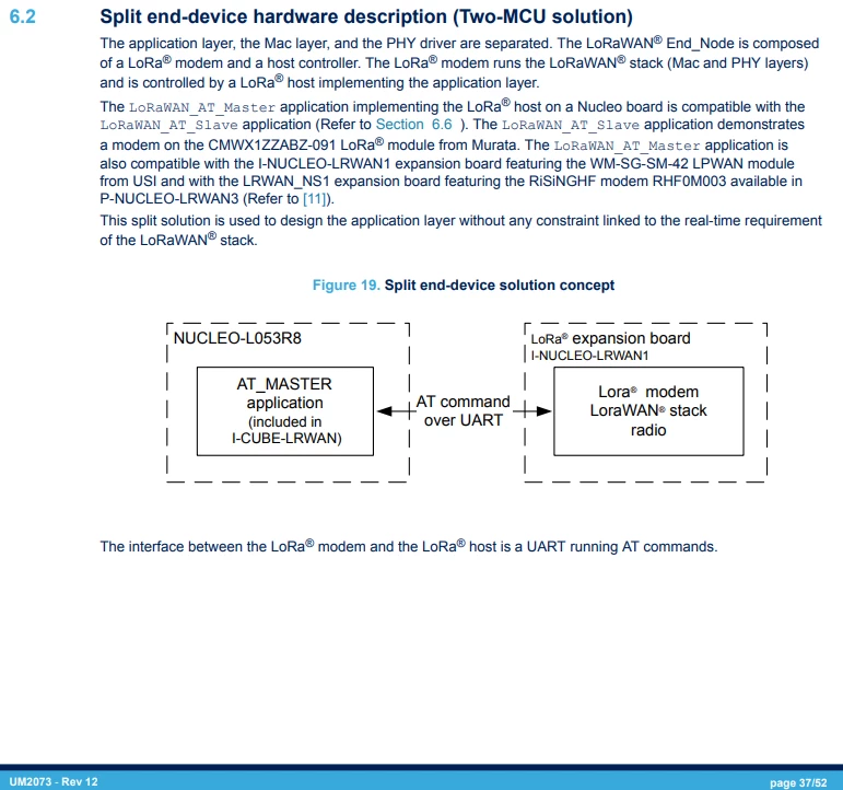

I recently got the P-NUCLEO-LRWAN2 board. I'm trying to set up the end node NUCLEO L073RZ using STM32IDE. I want to flash the firmware to the end node, get response from it for AT commands in Tera Term and connect it to TTN.
Please provide the step by step procedure to set up the end node.

@Andrew Neil wrote:
IIRC, it's called "AT Slave" or somesuch ...
This:
https://www.st.com/resource/en/user_manual/um2073-stm32-lorawan-expansion-package-for-stm32cube-stmicroelectronics.pdf#page=37
via: https://www.st.com/en/embedded-software/i-cube-lrwan.html#documentation

yes I'm working on the same project as @Kavin1 . Can you please help us with the detailed configuration steps required to setup the endnode NUCLEO-L073RZ from the P-NUCLEO-LRWAN2 kit. We are not getting any response in the tera term from the end node. We tried flashing the binary file using STM32CubeProgrammer. But still we are not getting any response from tera term.

I have navigated to the Projects->NUCLEO-L073RZ->APPLICATIONS->LoRaWAN->LoRaWAN_End_Node.->sx1272 in the i-cube-lrwan package for the end node. Can you please let me know the next steps I should take to get response from the end node for AT commands since I'm not getting any response now even after trying what is done in the P-NUCLEO-LRWAN2 pack documentation.
Are you sure that's the correct project?
The end-node in the P-NUCLEO-LRWAN2 has the USI module - it's not a bare SX1272.

The L073RZ controls the USI module via AT commands - so you need to program it with the code for that.
