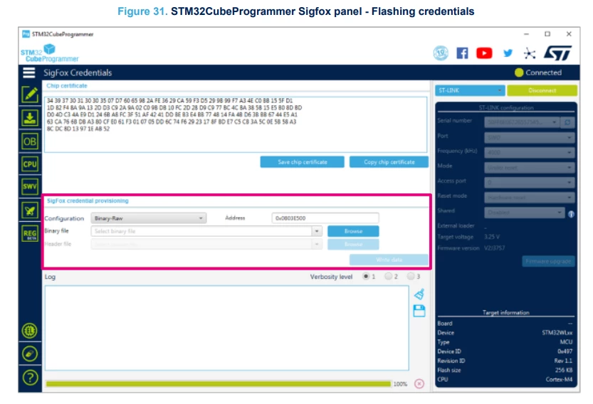

I have issues when I tried to use my nucleo 32WL with Sigfox (working well with LoraWAN).
I followed the steps proposed in the AN5480 :
working well for that :
0693W00000HqjppQAB.pngHowever, in practice when I try to obtain my ID and my PCA throught AT command, the values are wrong ! (don't match with the one in the header file)
The sigfox activation works only with the one in the header file (and not with the ID and PAC obtained thanks to AT commands)
Thus, it seems that there is a problem in the sigfox credentiel provisioning but Cubeprogrammer said that it is a success...

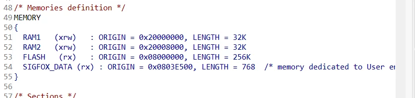

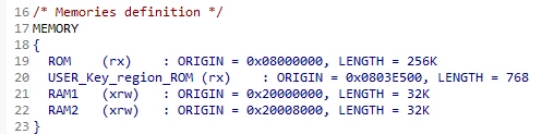

Hello Louis,
What is the hardware's memory you are using ?
You have to match the address in cube programmer "0x0803E500", and the one written in the STM32WL55JCIX_FLASH.ld file, corresponding to the "USER_Key_region_ROM" variable.
This address is valid for 256k memory, but if you use a different one this value may change.
In STM32WL55JCIX_FLASH.ld :
and in CubeProgrammer :
Let me know if this resolve the issue
Regards

I have all the default parameters.
In STM32WL55JCIX_FLASH.ld, I have :
0693W00000KcSr4QAF.pngand in CubeProgrammer :
Unfortunately, It doesn't revolve the issue
Best regards

LLr.1
LLr.1Author
Mar 14, 2022 1:05 PM UTC
Don't forget to erase all the FLASH memory -> the reflash is not enough ? Thus, you advice me to erase all the flash memory accord to STM32Cube programmer ?
0693W00000KcVpWQAV.pngBest regards
Louis AUDOLY
Mar 14, 2022 1:23 PM UTC
Should be enough, but at least you won't have any issue for sure !
Yes you can do it via CubeProgrammer, and then reflash your board.
Thanks for the Best Answer
Regards
