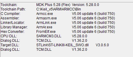

Build details:
Can anyone suggest me, that something i had done wrong in this!
