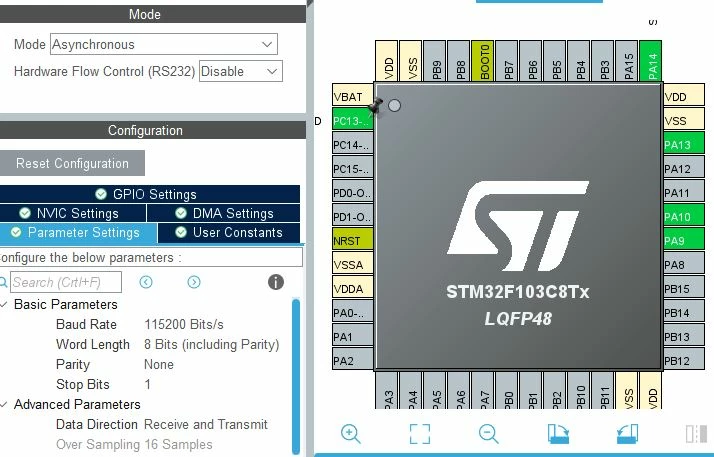

You've coded the solution incorrectly?
You have the wrong pins?
You haven't crossed the RX/TX between the micro-controllers?
The clocks are wrong?
Suggest to get a scope, and test one outputting a 'U' data pattern in a continuous loop, check the bit timing and that it's using the expected pin, etc.

Aug 9, 2021 6:11 AM UTC
thank you for your reply
the clocks were wrong
i put 48Mhz on stmwl55jc2 and 72MHz on stm32f103c8t6 then uart worked fine

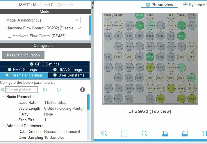

Aug 6, 2021 3:26 PM UTC
Check that the HSITRIM value in the WL55JC2 is being set correctly.
SSaya.1
SSaya.1Author
Aug 9, 2021 6:18 AM UTC
wl55jc has MSI, i used MSI clock
