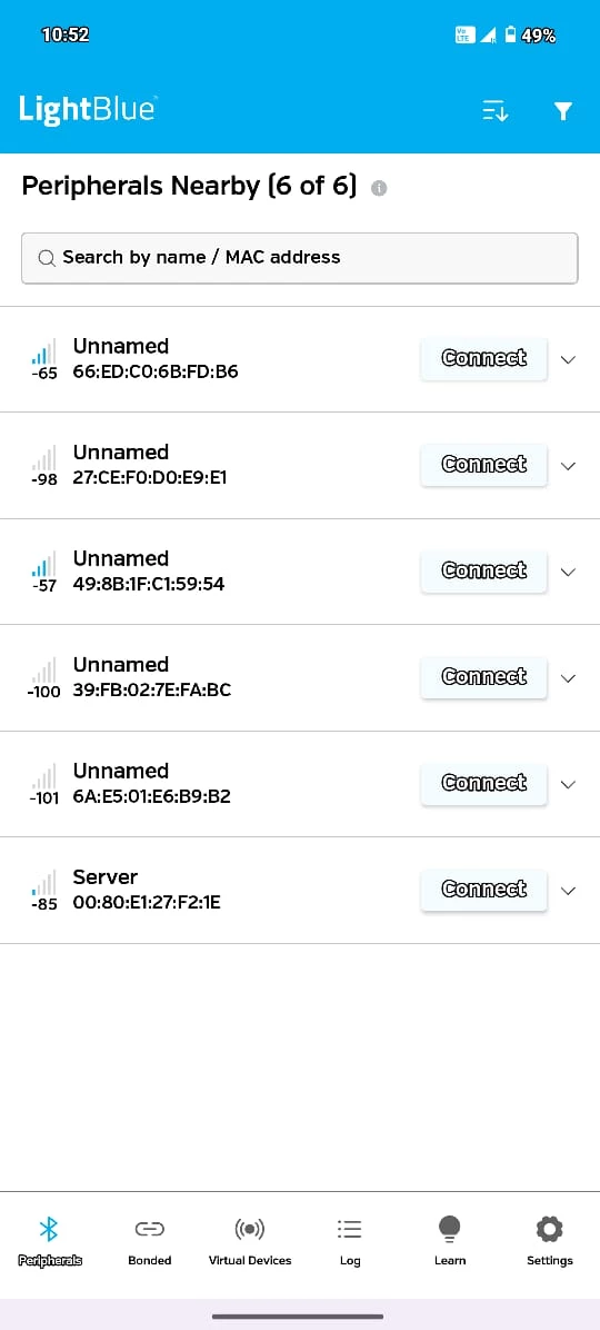

As previously mentioned in the other post I am using the 2 stm32wb55rev6 controller.I have setted the initial node connected to the cube monitor (using the aci facilities menu) to sca mode.And set the pheripheral application running on the other board (BLE_p2p SERVER).
In normal mobile app i am able to see the Ble p2p_server but while i am scanning in the transparent mode i am not able to see the p2p_server.
This is the p2p_server that is showing in the app.

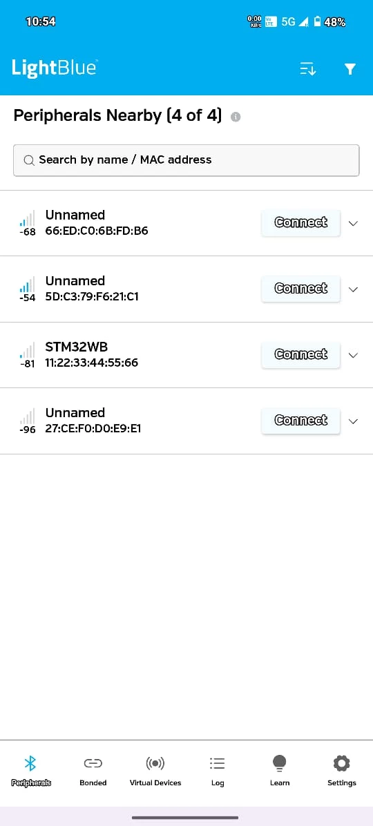

This is the transparent mode peripheral (STM32WB) in the app while advertising.

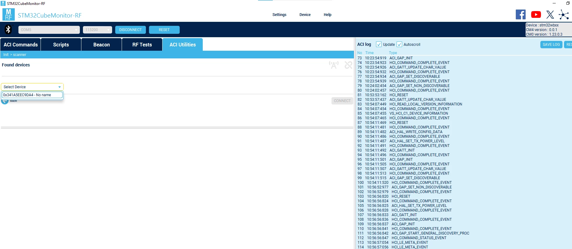

In the cube monitor p2p_server is ot showing.What is the issue?
How to resolve this?

It works fine for me. I'm not able to duplicate this behavior with the same SW but using the NUCLEO-WB55CG. It should work fine for me. Could you please try to test it using one of our NUCLEO boards connected to the STM32CubeMonitor-RF.

I'm not able to reproduce this behavior on my side. Are you using the last version of the STM32CubeMonoitor-RF (V2.18.0). Could you please try to ensure that you are using the best HW and SW combination.

Yes,i am using the latest hardware and software combination.
I am using the latest version of the cube monitor rf.
