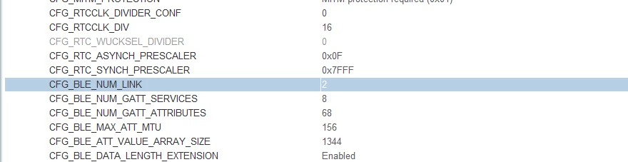

I've build a central device that need to connect to at least 4 hosts devices
it periodically loops on a aci_gap_start_general_discovery_proc()
when find a device that fits mac filter it connect itself and restart a scan period
but when it get connected to 2nd hosts next call to aci_gap_start_general_discovery_proc() return a BLE_STATUS_NO_VALID_SLOT result
my understanding is that CM0 can't deal with enought "state machines" as quickly mentionned in ble_defs.h
/* Returned when no valid slots are available
* (e.g. when there are no available state machines).
#define BLE_STATUS_NO_VALID_SLOT 0x82U
I didn't find any details in an5270
Can I set maximum state machine count a bit higher in config ??
thank's for any help

sorry I missed this parameter
