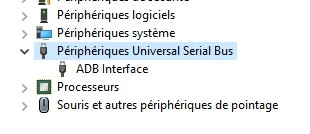

In the USB device manager I see that "ADB interface".
In the ST folder I tried to install the STLINK driver but it does not change my error.

So you did a failed upgrade?
Is the ADB Interface device the ST-LINK/V3 ?
If it's not in Device Manager as an ST-LINK not much hope of other apps "finding" it.​

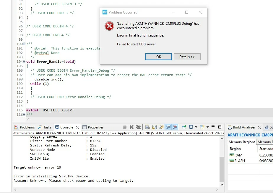

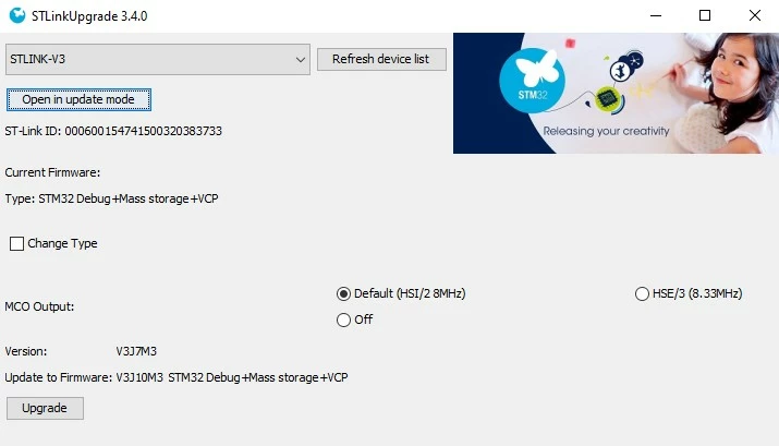

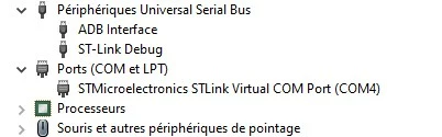

Good update : i've tried with a new cable and got this error : 0693W00000Uof1KQAR.jpg0693W00000Uof1AQAR.jpgI've done this update before the error above : 0693W00000Uof2NQAR.jpg
ChahinezC
Oct 24, 2022 1:09 PM UTC
Hello @BNamu.1​,
Based on the screenshot you shared, an update is required again. You can click on "Upgrade" to update the ST-Link FW and solve the issue.

I have done this upgrade , i got this error now :

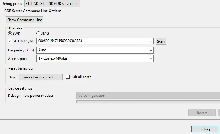

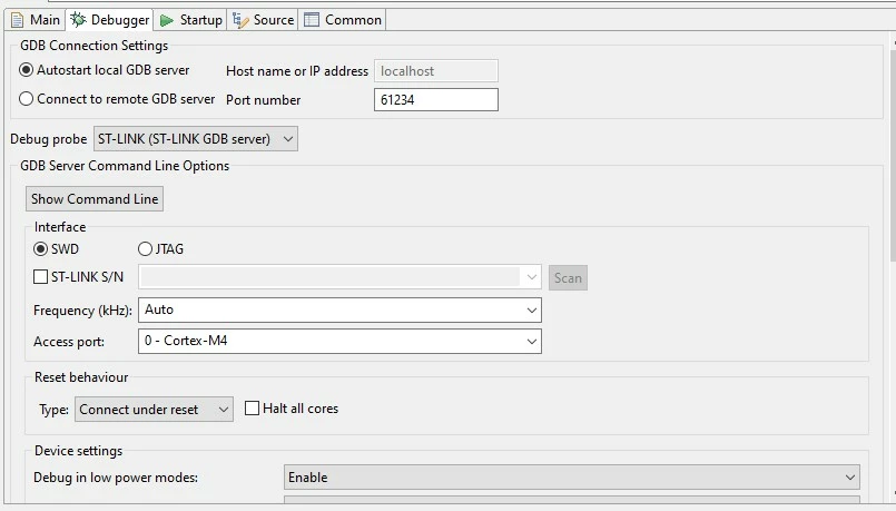

Oct 24, 2022 4:48 PM UTC
@Community member​
0693W00000UogaVQAR.jpgI was already using "Connect Under Reset" and i also tried the others...
The board is now working properly on the Arduino Environment but i have to use STM32 IDE to use LoRa

Oct 24, 2022 5:08 PM UTC
>>..but i have to use STM32 IDE to use LoRa
Trying to establish why it's not working, STM32 CubeIDE gets in the way of itself for the purposes of diagnosing what exact is wrong.
Pulling BOOT0 High can keep it from entering user code, perhaps allowing for that to be erased if it's putting the chip to sleep.
