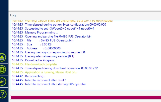

No issues flashing STM32WB55 M4 via STM32CubeIDE but cannot flash coprocessor with BLE stack with STM32CubeProgrammer.
Here is the output of STM32CubeIDE on flashing the custom board:

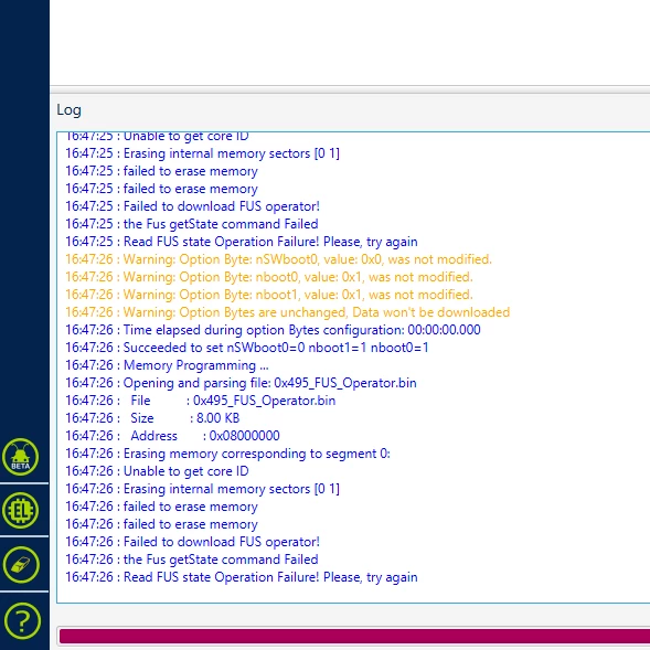

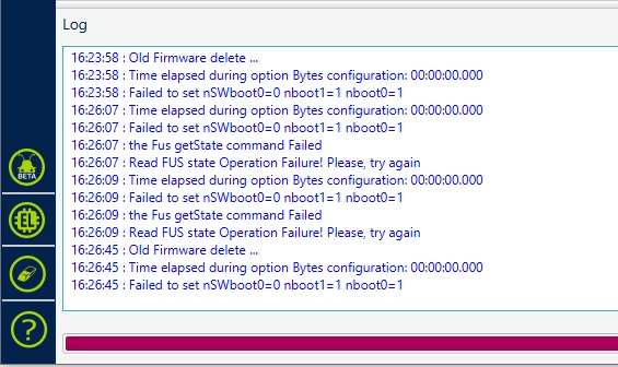

On STM32CubeProgrammer I am not able to consistently get a connection (by hitting the connect button).
There are some instances if the configuration is set to "Shared" mode that the device connects but there is no way to write/read to the FUS or perform any flashing.
Here's some screenshots of the outputs I've seen while attempting to write to the FUS using Programmer:
I've had a hard time figuring out how to approach debugging this issue since I have not been able to get consistent results.
Any advice or suggestions is much appreciated, thank you.

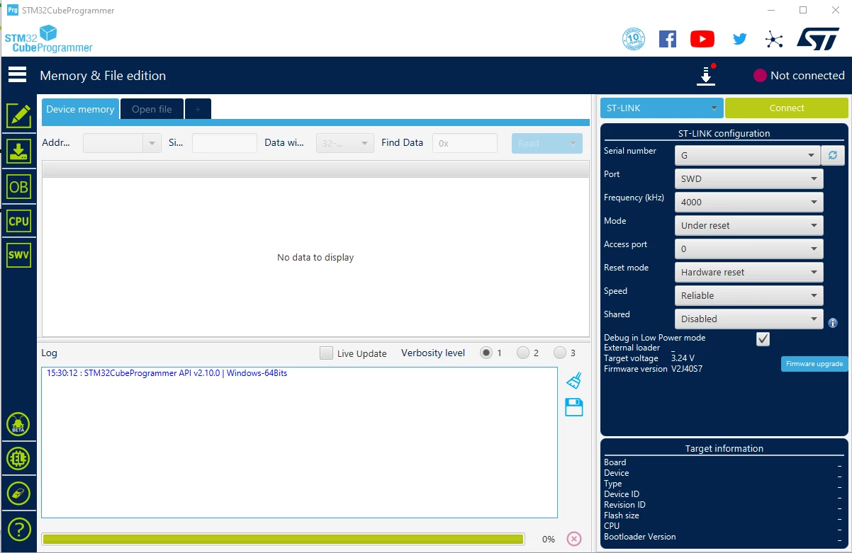

Sep 12, 2022 2:22 PM UTC
Seems FUS cant reconnect to Programmer app. Try change config to shared disabled .
MSuva.1
MSuva.1Author
Sep 12, 2022 2:32 PM UTC
If I have shared disabled then there is no communication.
0693W00000SvAfeQAF.pngPressing "Connect" in the above window with Shared set to "Disabled" yields no response from the software.

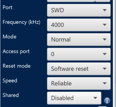

Can you try to connect using STM32CubeProgrammer with the following parameters:
Then try the following steps:
> Perform a full chip erase
> Start the FUS
> Read FUS
> Perform a FUS upgrade
If it's not working, can you share the log from STM32cubeProgrammer with verbosity level at 3 and the option bytes configuration ?

Sep 27, 2022 2:37 PM UTC
I am not able to connect to the board at all with the "Shared" option set to Disabled. It has to be enabled or else pressing connect does nothing.

According to UM2237, the "Shared" option allows connection of two or more instances of STM32CubeProgrammer or other debugger to the same ST-LINK probe. So, if you can't connect to the board when the "Shared" option is set to Disabled, maybe your board is connected to another software.
