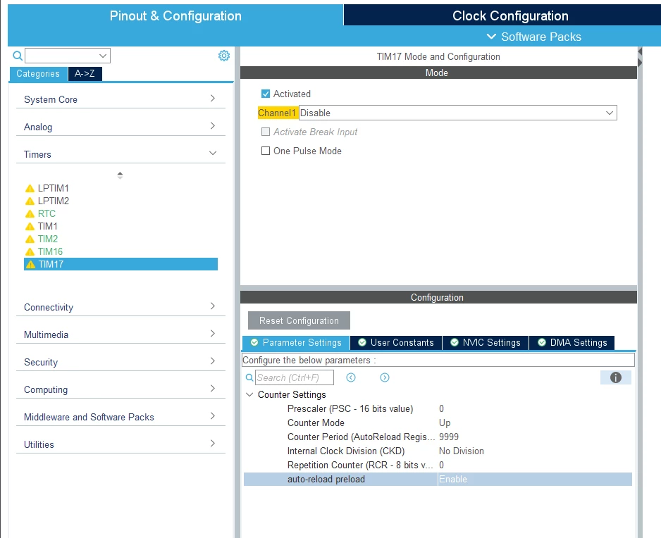

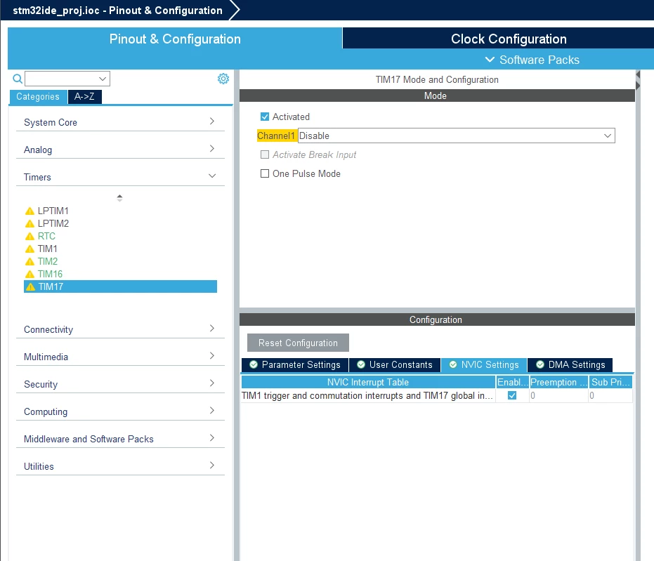

TIM17 cube config
TIM17 cube nvic config:

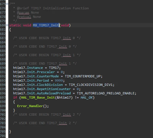

Generated init code, its exactly the same as the TIM16 code:

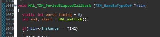

Here is a subset of my interrupt handler code.  There's a large if-else block in here that checks TIM2, TIM16, and TIM17.

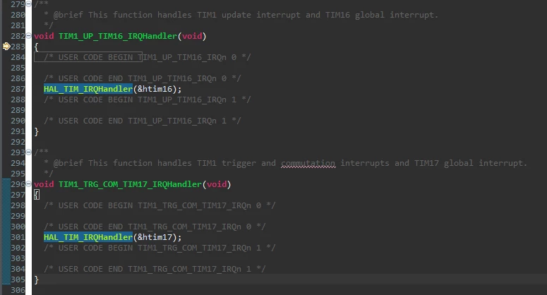

Cube auto generates these functions, which I believe are the actual interrupt vectors.  HAL_TIM_IRQHandler will call HAL_TIME_PeriodElapsedCallback.  TIM1_TRG_COM_TIM17_IRQHandler is never called.

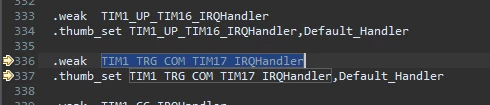

In the startup assembly file you can see the TIM16 and 17 blocks:

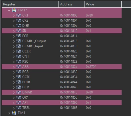

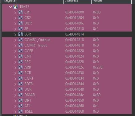

Here's the TIM17 registers right after the config is done, and then here it is after the program has run for a bit:

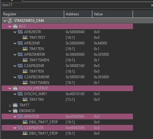

Also, here's a grab of every register that contained the word "tim17"
waclawek.jan
waclawek.janBest answer
Oct 20, 2024 9:51 AM UTC
> I'll have to read the documentation some more to get the relevant RCC and NVIC registers.
That too, but also read the TIM chapter.
TIM17_DIER=0 means, that there is no interrupt enabled for TIM17.
TIM17_CR1=0x80 means that TIM17_CR1.CEN=0 i.e. TIM17 does not run.

Thanks all,
I had a typo when I copied and pasted HAL_TIM_Base_Start_IT and I wasn't checking the return value.
