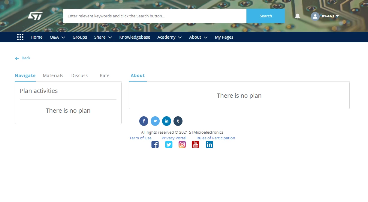

RSakh.1
RSakh.1Author
Jul 13, 2021 1:26 PM UTC
Hi @Imen DAHMEN​
When click on "Access the Course" I don't see any material in it, below is screen shot. I have log-in credentials registered on STM.
 0693W00000BdYegQAF.pngIs there anything I am missing here ??
