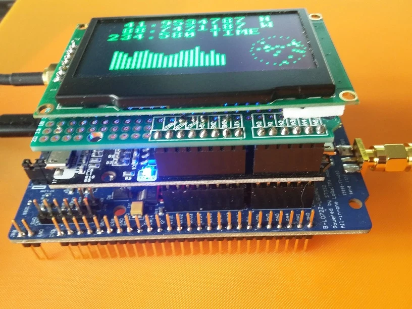

No, you don't put an Arduino Uno on top, nor use the Arduino IDE.
The shield connector on the DISCO board connects to the CPU within the Murata radio and allows you to plug in user shields, say GPS or OLED, etc. It replaces the Arduino Uno in the equation.
The software they provide that uses "make all" is the github project, described on the cited page, using the GNU tools chain for which they provide a link to, you will have to install that, and then run the make process from the command line.
Installing STM32Cube, either the IDE or MX probably won't get you far. The I-CUBE-LRWAN package is pretty much free standing, with projects buildable in Keil, IAR, etc. I use Keil, there is a free licence for STM32 Cortex-M0(+) parts.
You also don't need the external ST-LINK, the DISCO board contains a built-in ST-LINK that connects via the micro-USB connector on the North end of the board, the LoRa Antenna being on the South end. The micro-USB on the lower East side connects to the Murata module, but needs suitable firmware on the module to function.

Software in the Murata module is using the GPS module in the lower position, and driving the display in the upper position. The thing is entirely self contained. I'm using the LoRa radio here, not using LoRaWAN.
If you install the STM32 Cube Programmer software it should have all the drivers required, and should allow you to burn firmware images in .ELF, .BIN or .HEX formats onto the module.
https://www.st.com/en/development-tools/stm32cubeprog.html
