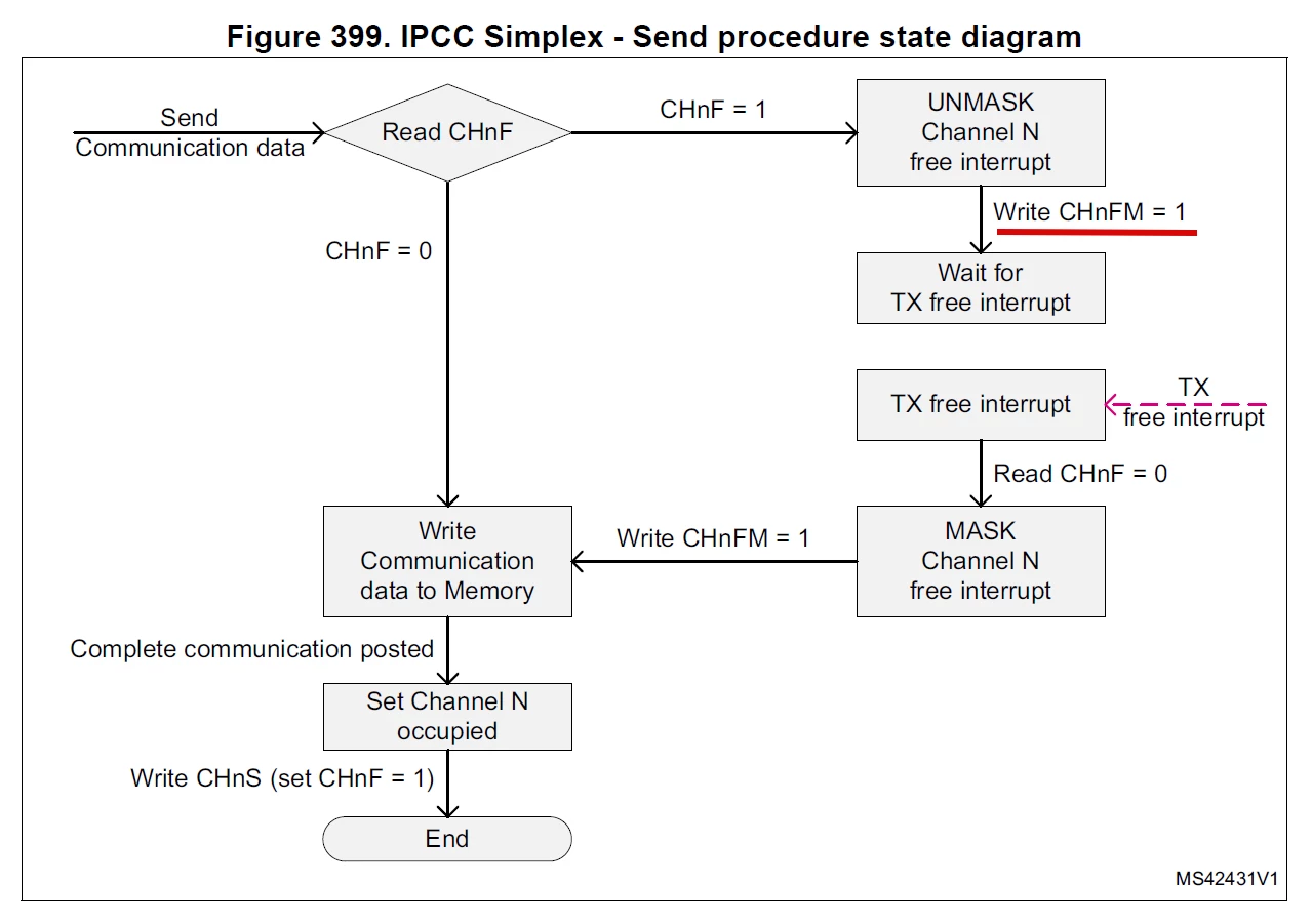

I found a mistake in RM0434 in IPCC description.
Figure 399 IPCC Simplex - Send procedure state diagram.
After the rectangle with "UNMASK Channel N free interrupt" should be "Write CHnFM = 0" instead of "Write CHnFM = 1"
Thanks.

Thank you, ticket entered.
It will be checked.
