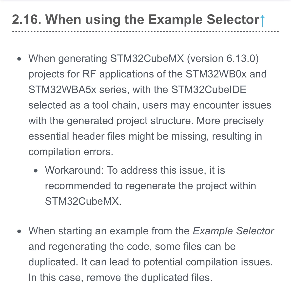

Missing stm32wbaxx_hal_pka.c file
After generating the BLE_Sensor project files for the B-WBA5M-WPAN board with STM32CubeMX Version 6.17.0, the STM32CubeIDE shown this error. I looked for the file in STM32Cube_FW_WBA_V1.9.0 and it is not there. Please advise.
10:56:39 **** Incremental Build of configuration Debug for project BLE_Sensor ****
make -j9 all
make: *** No rule to make target '/Users/user/STM32Cube/Example/BLE_Sensor/Drivers/STM32WBAxx_HAL_Driver/Src/stm32wbaxx_hal_pka.c', needed by 'Drivers/STM32WBAxx_HAL_Driver/stm32wbaxx_hal_pka.o'. Stop.
"make -j9 all" terminated with exit code 2. Build might be incomplete.

Hello ​@dc2ac
Could you please try to click at "Open Projects from File System" to open the example
Then, choose the "Directory"
If you want to generate code from .ioc file using STM32CubeMX toolchain, I recommend you to copy the .ioc file in a new workspace then generate code and open the project using STM32CubeIDE.
This is a know issue for CubeMX:
Ps: the same issue has been answered here.
Best Regards.

Thanks. I got it working.
