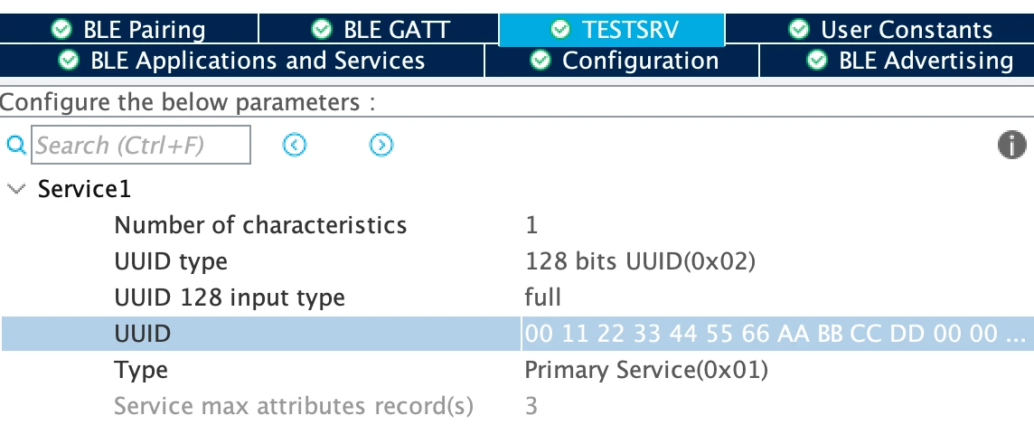

Missing macro COPY_UUID_128 after changing UUID in CubeMX
When creating a custom template BLE app in CubeMX everything works fine while not changing the UUID of service1, it builds and compiles well. But if I change the UUID to my own UUID (with UUID 128 input type to full), after generating the new code an error pops up: undefined reference to `COPY_UUID_128'
It appears the macro COPY_UUID_128 is missing now, after I add it myself in the USER CODE area, it compiles again (custom_stm.c):
#define COPY_UUID_128(uuid_struct, uuid_15, uuid_14, uuid_13, uuid_12, uuid_11, uuid_10, uuid_9, uuid_8, uuid_7, uuid_6, uuid_5, uuid_4, uuid_3, uuid_2, uuid_1, uuid_0) \
do {\
uuid_struct[0] = uuid_0; uuid_struct[1] = uuid_1; uuid_struct[2] = uuid_2; uuid_struct[3] = uuid_3; \
uuid_struct[4] = uuid_4; uuid_struct[5] = uuid_5; uuid_struct[6] = uuid_6; uuid_struct[7] = uuid_7; \
uuid_struct[8] = uuid_8; uuid_struct[9] = uuid_9; uuid_struct[10] = uuid_10; uuid_struct[11] = uuid_11; \
uuid_struct[12] = uuid_12; uuid_struct[13] = uuid_13; uuid_struct[14] = uuid_14; uuid_struct[15] = uuid_15; \
}while(0)
Used version of CubeMX is 6.11.0 on the Mac, VSCode with STM extension, firmware 1.19.0

Remyhx
RemyhxAuthor
Apr 2, 2024 4:26 PM UTC
@STTwo-32 I did as you asked: when I changed the UUID 128 input type from reduced to full and enter the new UUID, generate the code files, it generates in custom_stm.c the correct UUID's... but without the macro COPY_UUID_128. If I copy this macro before the change and paste it in USER CODE, it will work. If I change the UUID 128 input type again back to reduced, it will put the macro back in.
The Links to the 'old' ioc and 'new' ioc: Google Drive
Image for clarity.
