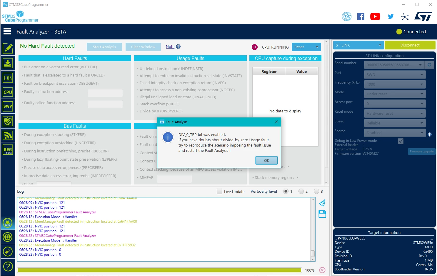

MemManage fault detected in instruction located at 0x6414AA00.
I'm developing a custom board with STM32WB55.
Because there is some error during debugging, I'm trying to solve it.
To check what is problem in the microcontroller, I tried Fault Analyzer in the STM32CubeProgrammer and the program found such an error below.
"MemManage fault detected in instruction located at 0x6414AA00"
0693W00000Uo1lDQAR.pngHere is the question.
How can I understand what's this error and how can I fix it?

According to UM2237 documentation the Memory Management Fault detects memory access violations to regions defined in the memory management unit (MPU), such as code execution from a memory region with read/write access only. If this fault was triggered by a faulty address, access is displayed on the MMFAR text field.
For the second point DIV_0_TRP allow to enable Usage Fault when the processor executes an SDIV or UDIV instruction with a 0 divider:
  • 0 = do not trap divide by 0; a divide by 0 returns a quotient of 0.
  • 1 = trap divide by 0.

I can see this error also.0693W00000Uo1jxQAB.pngDIV_0_TRP bit was enabled.
What is this? and How can I understand this error and fix it?

Thanks for your reply...this problem is solved.
