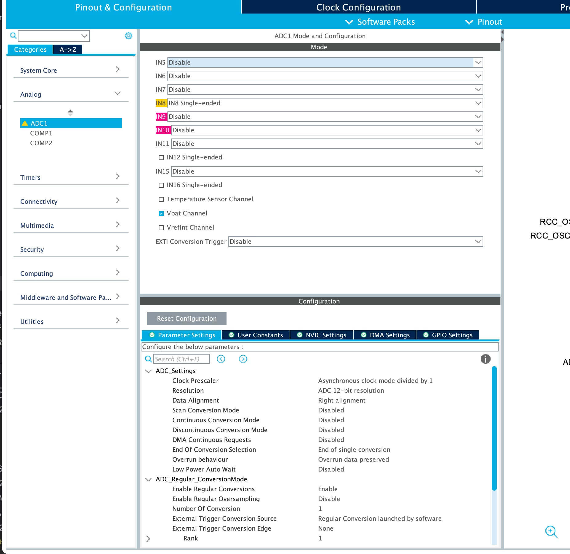

I have setup ADC1 and enabled the VBatChannel (at least in CubeMX).
My Question is how to read out the ADC Value of VBAT?
So far i have tried the following:

My CubeMX ADC Config

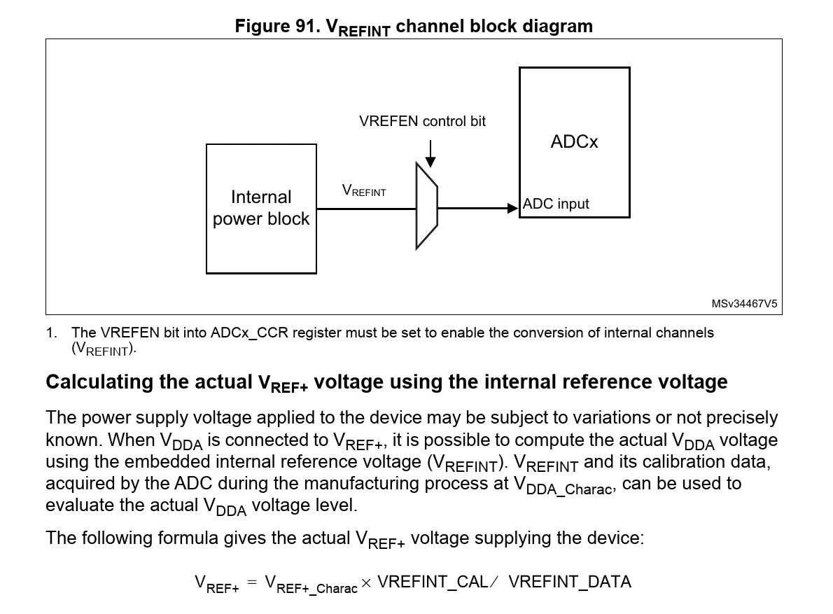

 If "bla" is the refint channel you set with Cube , then :
HAL_ADC_Start(&hadc1);
while ((HAL_ADC_GetState(&hadc1), HAL_ADC_STATE_READY) == 0);
// adc value = vrefint (1.212 V)
vbat = 1.212f * 4096 / (float) HAL_ADC_GetValue(&hadc1) ;
To get good/best precision, you have to adjust the "1.21" to 1.1x.. 1.3x , to match the real vbat you see on a DMM .
Note: It is recommended to perform a calibration after each power-up. (adc_ex_calibration_start(..))

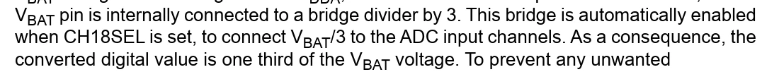

>  At least i get values like 33% battery power at 3V VBat.
see rm : ADC->VBAT
So 1/3 vbat is perfect.. :)

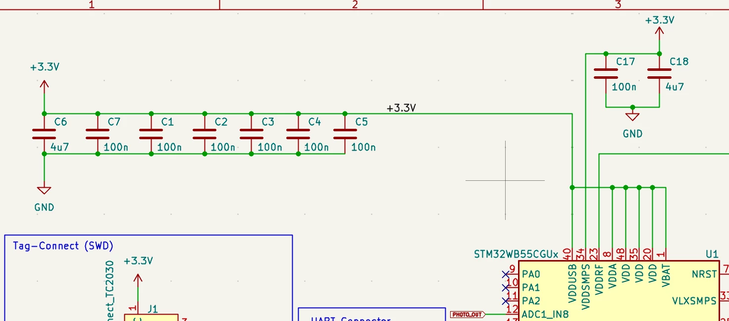

VBAT is connected to a 3V Battery, and all other VDD pins are connected to the same battery since the board is only powered by this battery.
So also VREF+  to the ADC ? Then you always just check the 1/3 divider !
VREF+ has to be at a fix reference level, to check the supply or bat voltage, otherwise the adc-full-reference scales with the applied voltage and you can get no useful info.
So if leaving VREF+ at VBAT , measure the (fixed) internal voltage and calculate Vbat and Vref from this:
read in rm...

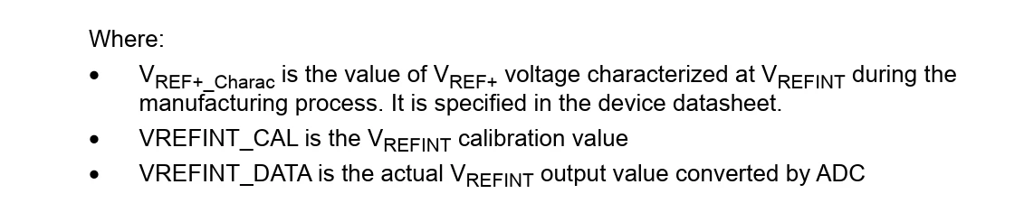

ExeuAuthor
Jun 8, 2024 6:49 PM UTC
My MCU seems to not have a dedicated VREF+ pin. I am using the 48 pin package where this seems to be not present. Only in the bigger packages i can see a VREF+ pin.
I didn't see the formula about VREF+ though, but if seeing this reading the manual does not bring me anything since i still don't know how to translate this into "code".
Where to get VREFINT_CAL and VREFINT_DATA from?
And what is VREF+_Charac ?
There is no example in the wide world of STM of how to do this. At least i couldn't find any
AScha.3
Jun 8, 2024 7:27 PM UTC

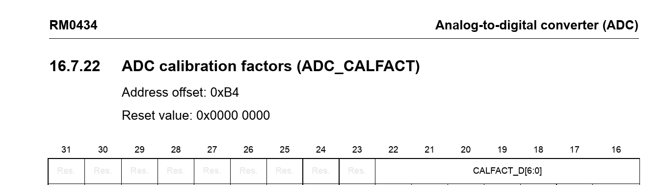

Just - did you look at the rm at all ?
The next lines after the Fig.91 (i showed) should tell it
Again : read in rm...
next: see also register descriptions:
