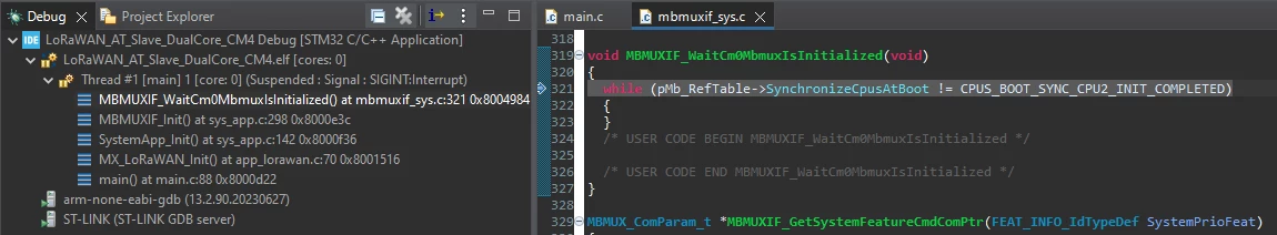

MBMUXIF_WaitCm0MbmuxIsInitialized infinite loop
Never gets past this check
void MBMUXIF_WaitCm0MbmuxIsInitialized(void)
 while (pMb_RefTable->SynchronizeCpusAtBoot != CPUS_BOOT_SYNC_CPU2_INIT_COMPLETED)
 /* USER CODE BEGIN MBMUXIF_WaitCm0MbmuxIsInitialized */
 /* USER CODE END MBMUXIF_WaitCm0MbmuxIsInitialized */

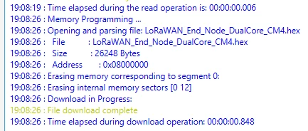

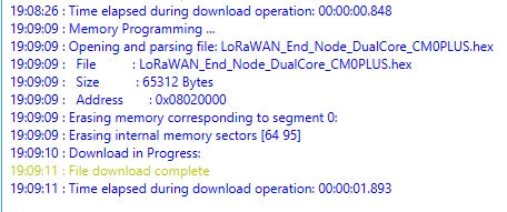

Dec 1, 2021 11:10 AM UTC
0693W00000GZdHpQAL.png0693W00000GZdJGQA1.pngthe code were downloaded with cube programmer , but the CM0 can not be Initialized

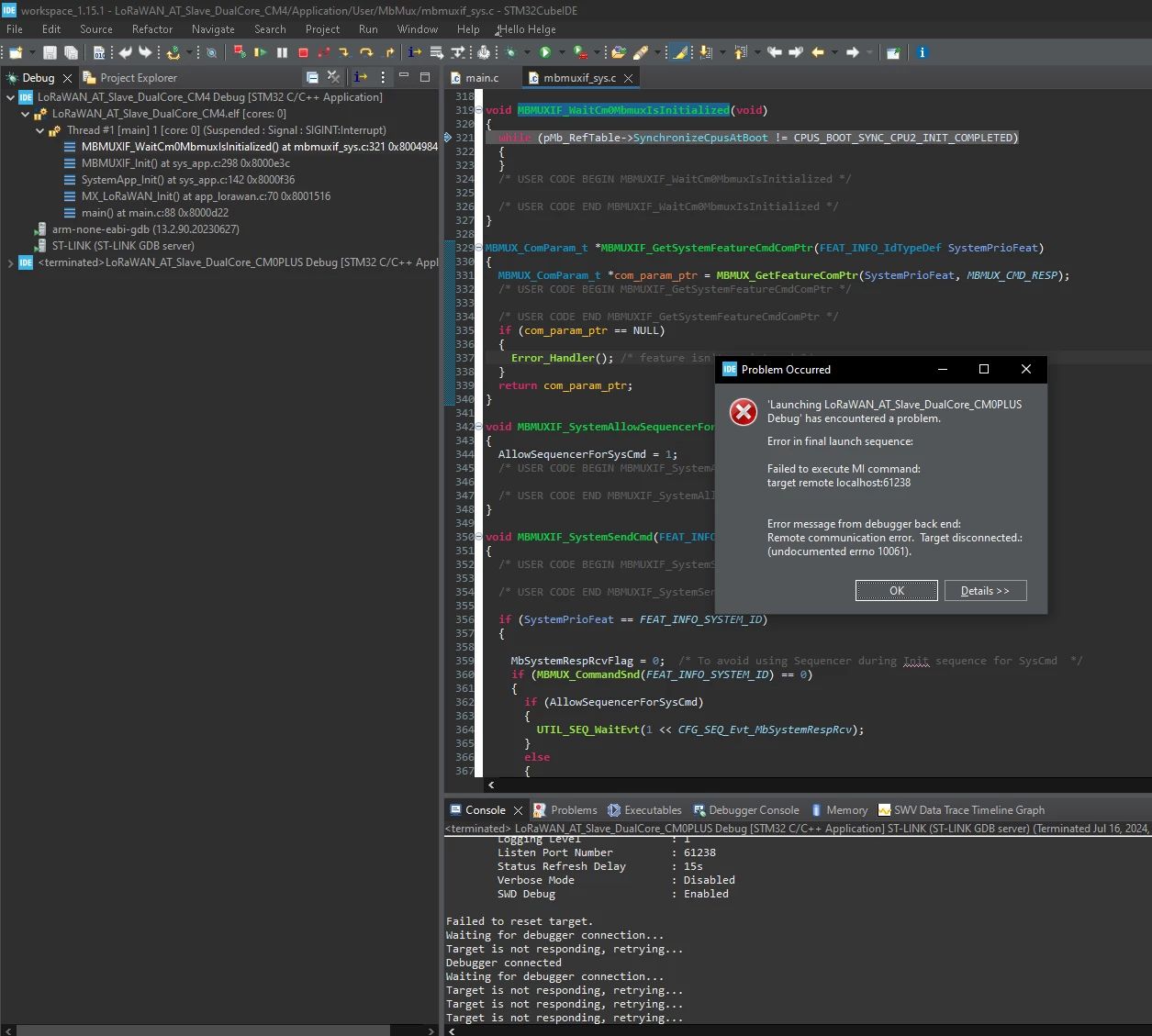

Hi, I successfully programmed the NUCLEO-WL55JC1 multiple times until I tried the FUOTA Dual Core demo like described in this video: Getting started with LoRaWAN FUOTA on STM32WL end device
Since then, I had a lot of issues with reprogramming. I finally managed to unlock the MCU using the STM32CubeProgrammer.
Now, I can reprogram the device with the LoRaWAN End Node Dual Core project (STM32Cube_FW_WL_V1.3.0), but I get the following terminal output:
There is a difference between the MAPPING_TABLE placement in memory: 0x20007000
and the address calculated according to the IPCCDBA option byte: 0x20008000
IPCCDBA is automatically updated
System restarting...
Please check the CM4\MbMux\mbmuxif_sys.c for more info

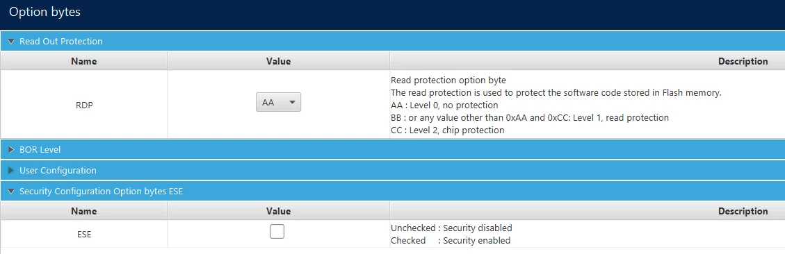

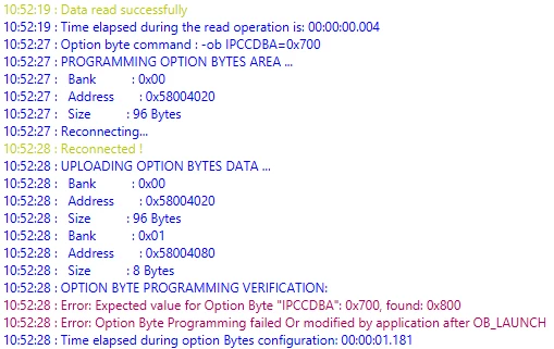

 If I connect with STM32CubeProgrammer and read out the option bytes I get this:
So the option bytes couldn't be updated by the application.
If I try to do it with the STM32CubeProgrammer tool, I also get an error:
Whereas RDP level is 0 and ESE is unchecked:
If I use the LoRaWAN AT Slave Dual core application I get stuck during:
If I try to debug CM0+ in parallel I get an error:

Jul 16, 2024 10:56 AM UTC
I was able to fix the problem by reading out the option bytes from a new board and write the exact same configuration to my board which had problems...
