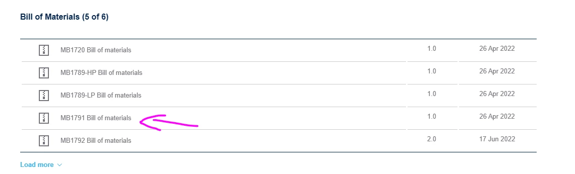

MB1791 Bill of materials
Hi Sir. Madam,
For MB1791 Development Broad, there are 3 Type of ​design:
  1. MB1791-HighBand_HighPower
  2. MB1791-HighBand_LowPower
  3. MB1791-LowBand_HighPower

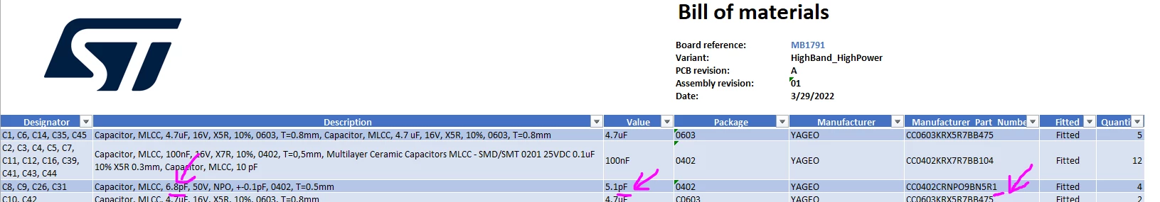

0693W00000bhSADQA2.pngBut I doubt the BOM given, the part Description, Value and Manufacture Part Number are not tally for the Location: C8, C9, C26, C31:.
Pls advise the correct value for ​MB1791-HighBand_HighPower.
Thanks.

Hello @KKan.1​ and welcome to ST Community
Thank you for bringing this to our attention!
I reported the issue internally.
Internal ticket number: 149284  (This is an internal tracking number and is not accessible or usable by customers)

Apr 17, 2023 10:50 AM UTC
Hello again @KKan.1​,
As mentioned earlier, documents will be updated soon with the right values, but I can inform you that the recommended value of C8, C9, C26, C31 is 6.8pF as it is mentioned in the board schematics:

Hi Sara,
Thanks for feedback.
For my understanding, Schematic is general for the 3 different Band & Power reference.
BOMs is the actual that we need to follow :
  1. BOM_MB1791-HighBand_HighPower
  2. BOM_MB1791-HighBand_LowPower
  3. BOM_MB1791-LowBand_HighPower
--> STM32WL55CC - Sub-GHz Wireless Microcontrollers. Dual-core Arm Cortex-M4/M0+ @48 MHz with 256 Kbytes of Flash memory, 64 Kbytes of SRAM. LoRa, (G)FSK, (G)MSK, BPSK modulations. AES 256-bit. Multiprotocol System-on-Chip. - STMicroelectronics
Pls advise.
Apr 19, 2023 10:59 AM UTC
Indeed, the BOM will be updated with the correct value 6.8pF, so you can safely use it before the update!
Hope that's clear!
