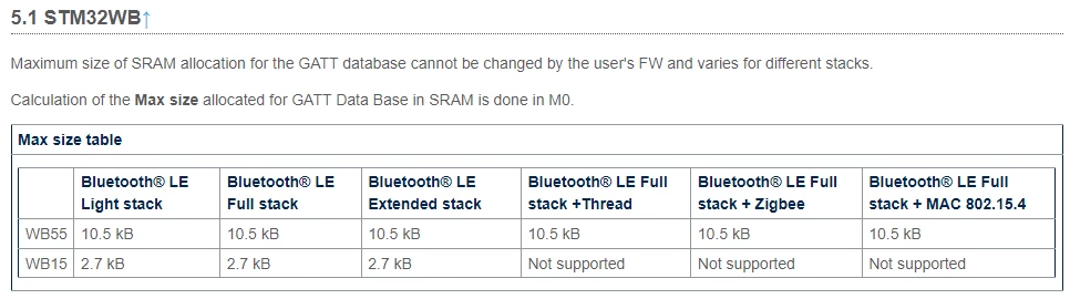

I'm looking for the max size of SRAM allocated for the GATT database for the STM32WB series.
I've found the informations for WB55 and WB15 but I can't find the information for WB10/30/35/50/. Does anyone know these values or how it can be calculated ?
I'm asking this question because I'm working with WB10 and I'm close to the max size permitted (2.7kB). I would like to know if the SRAM allocated for the GATT database is bigger for WB30.
Thanks for your help.

Regarding the max size of SRAM allocated for the GATT database for the STM32WB series, the constraint is the same for WB10 and WB15, for WB30/35/50 is the same than WB55.

Thanks a lot for your answer.
