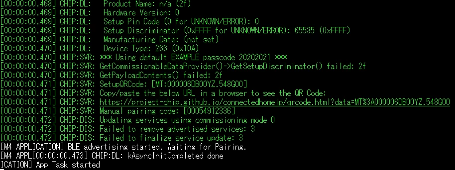

This project involves the development of Matter devices. We encountered an issue with commissioning the device using the obtained vendor ID. Despite following the necessary steps, the commissioning process fails. Below, we detail the steps taken and request assistance in resolving the issue.

Sorry, I was able to read the data written in genFactoryData.py and start Advertising and commissioning. it seems that the reason is that I did not write IterationCount, Spake2pSalt and salt.

Also, I have changed some parts of the FactoryDataProvider.cpp as you provided previously, but it seems that Serial Number, Product Name, Setup Pin Code, etc. cannot be read and Advertising is not started.
Can you please help me to find the cause of this problem?
