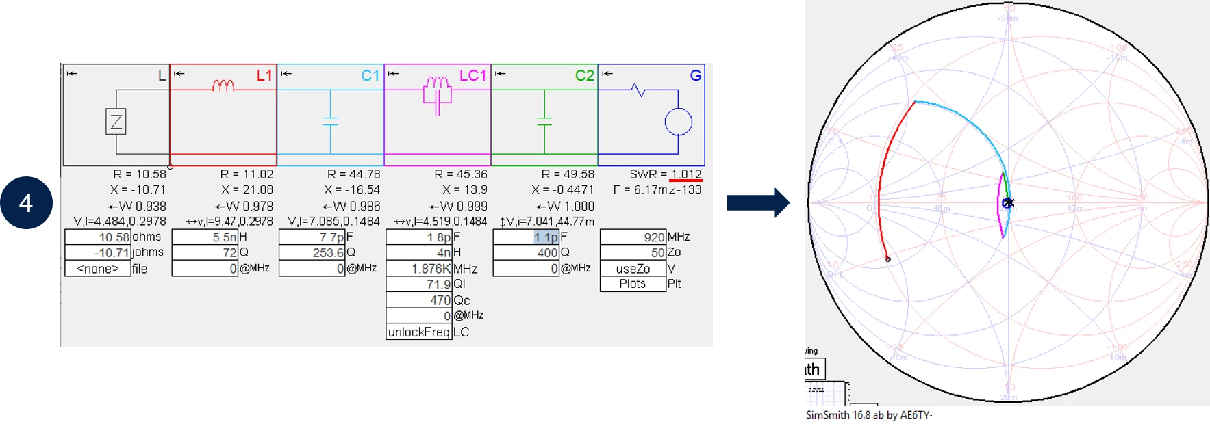

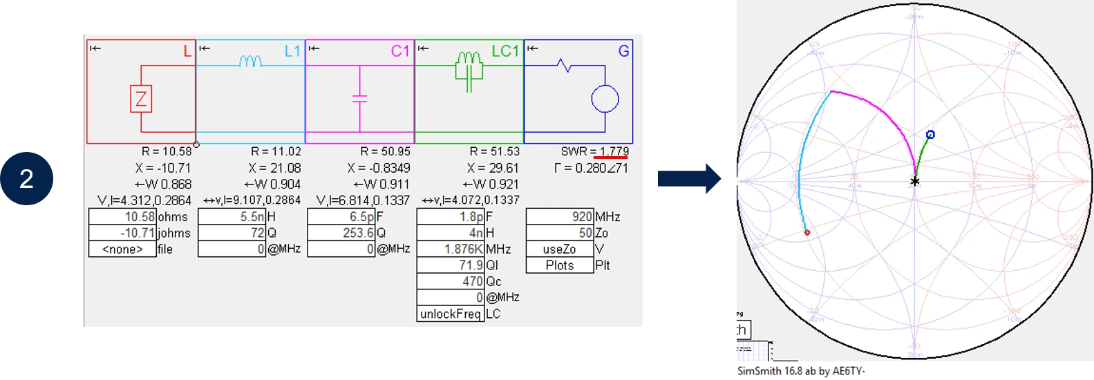

After going through AN5457 I want to confirm whether I have correctly followed the design guidelines presented.
I am aiming at 920MHz and have used the 923MHz 22 dBm value for Z0 (10.58-j10.71).
This is my first time dealing with RF but I understand that the aim is to reach the center of the smith chart and hence 50/0 Re/Im. On page 26 it gets a bit confusing as the notch filter chart clearly moves away from the 50 Ohm center point. This is the last chart in the document which shows the full network so I'm not sure if the remaining components are supposed to return to the center or not.
I have assumed that the end result should return to the center and therefore be as close to 50/0 as possible upon entering the RF switch. Is this the correct outcome or are the filtering stages not expected to return to the 50 Ohm value?
My smith chart and matching circuit are attached. All values on the components for Q are extracted from the murata SimSurfing tool.

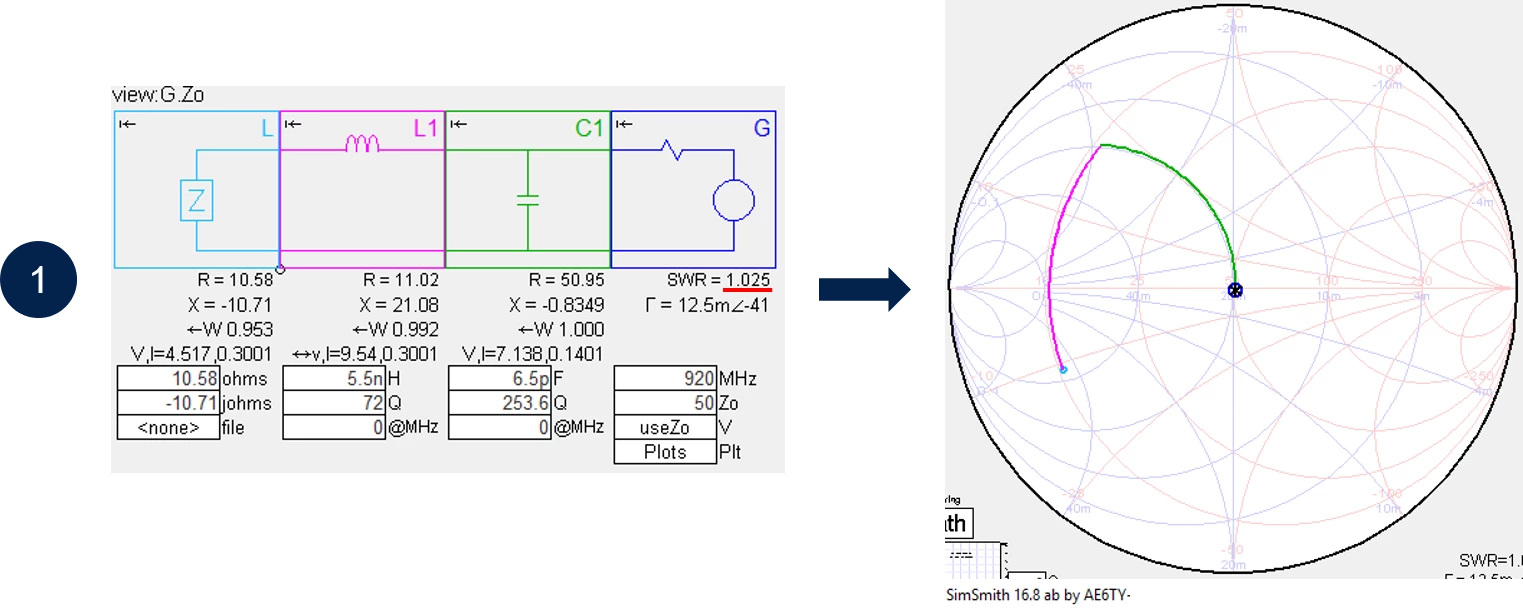

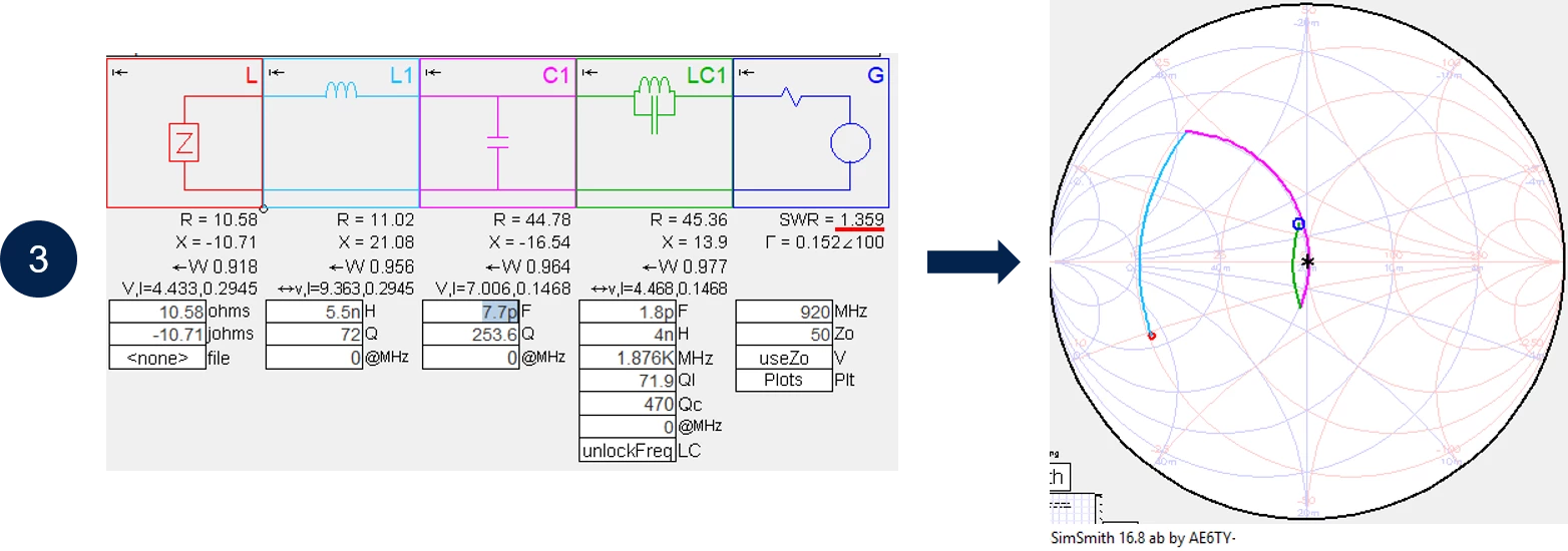

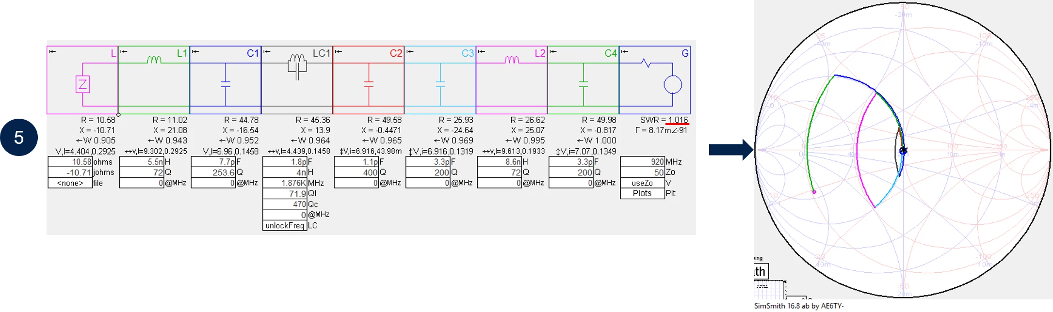

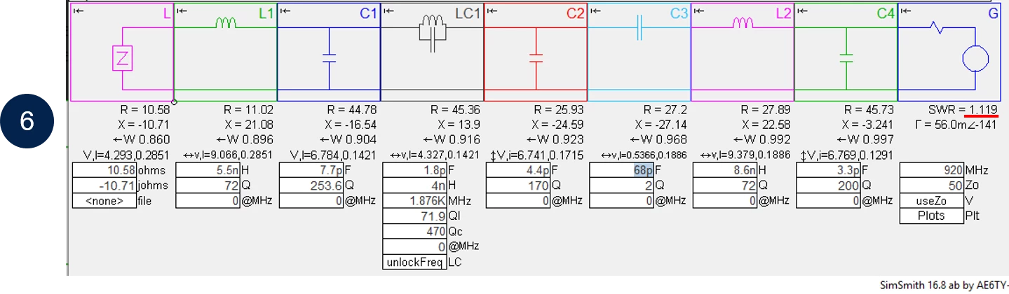

1) Generally the input impedance of the antenna is 50 ohms. Thus, after filtering stages, the output impedance of the network (towards antenna) should be equal to 50 ohms to ensure the maximum energy transfer to be radiated. I've attached some images to show you step by step this procedure from the impedance value chosen by you. I applied steps 1 and 3 on page 27 to get the attached images. Note that in these images the antenna is represented by the 920 MHz source (on the right) with an impedance value of 50 ohms. The VSWR is the one seen by the antenna. Remember that in this exercise, the goal is to minimize the VSWR seen by the antenna as much as possible.

0693W000006HfnRQAS.png0693W000006Hfo0QAC.png0693W000006HfoPQAS.png0693W000006HfojQAC.png0693W000006HfooQAC.png
(Combining the values of C2 and C3 and adding DC block capacitor)0693W000006HfpIQAS.png(correcting the mismatch introduced by the DC Block capacitor by changing the value of L2)0693W000006HfpSQAS.png

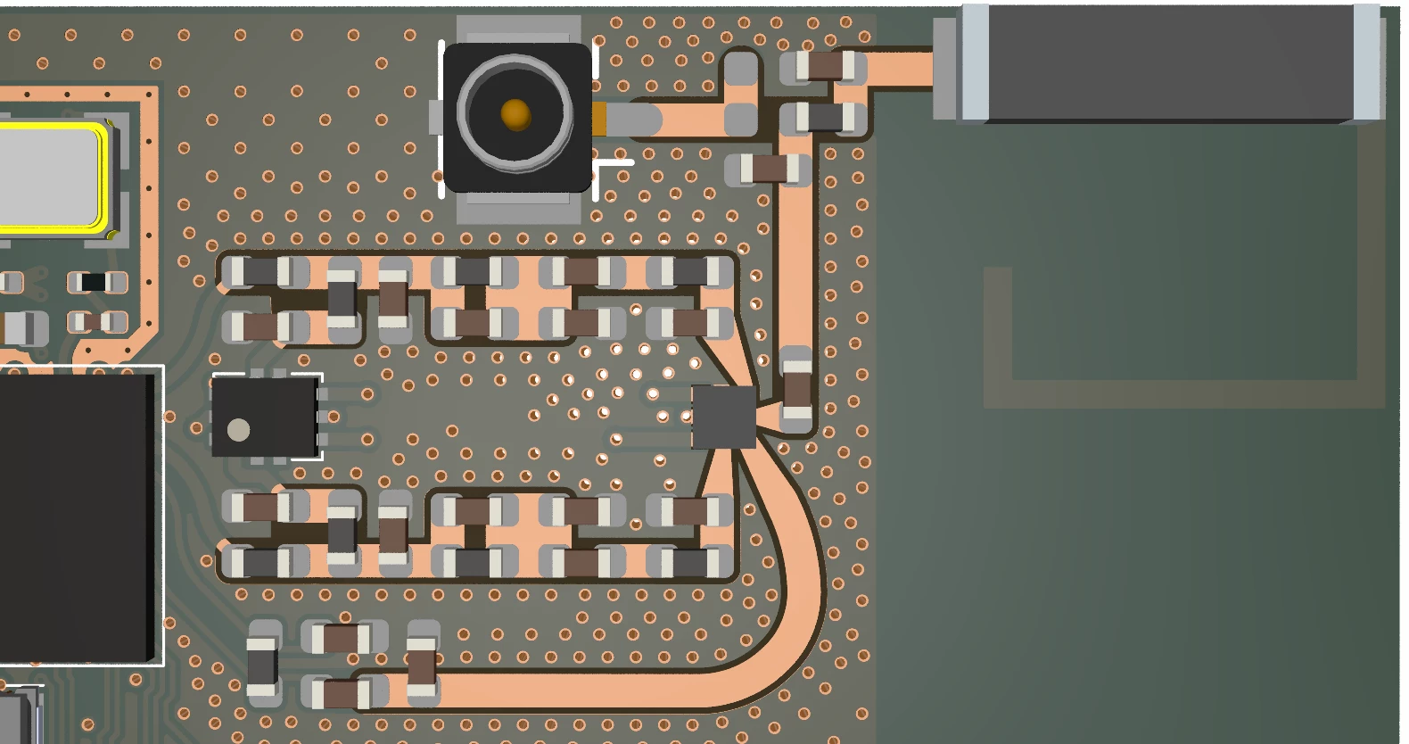

I have gone through as much reference material as I could find and have been trying to apply as much "best practice" as I can find to ensure good results. My final matching network is based mainly on the NUCLEO layout because of the 3-way RF switch and it looks like this:
 0693W000006HmKlQAK.pngSome notes on the layout:
  • I have kept mask off the GCPW lines to help control the dielectric coefficient. My main concerns are the corners (through components) leading to the antenna/u.FL as I'm not sure what impact that has on the signal, but it's something I've seen on professionally designed boards and helps save space.
  • I am also using a TCXO (TG2520SMN 32.0000M-ECGNNM3).
  • The PA goes through a TS3A52 DP/DT switch (on the left) instead of 2 discrete switches like in the MB1389D design.

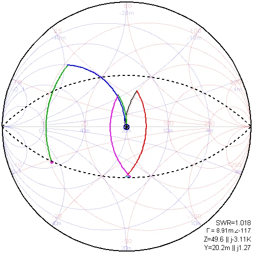

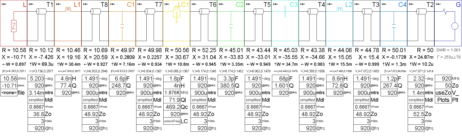

For the actual matching network, I have used the thickness/dielectric values from the MB1389D gerber stackup to add the PCB effects to the SimSmith by adding a transmission line between each component and taking the length from the PCB layout:

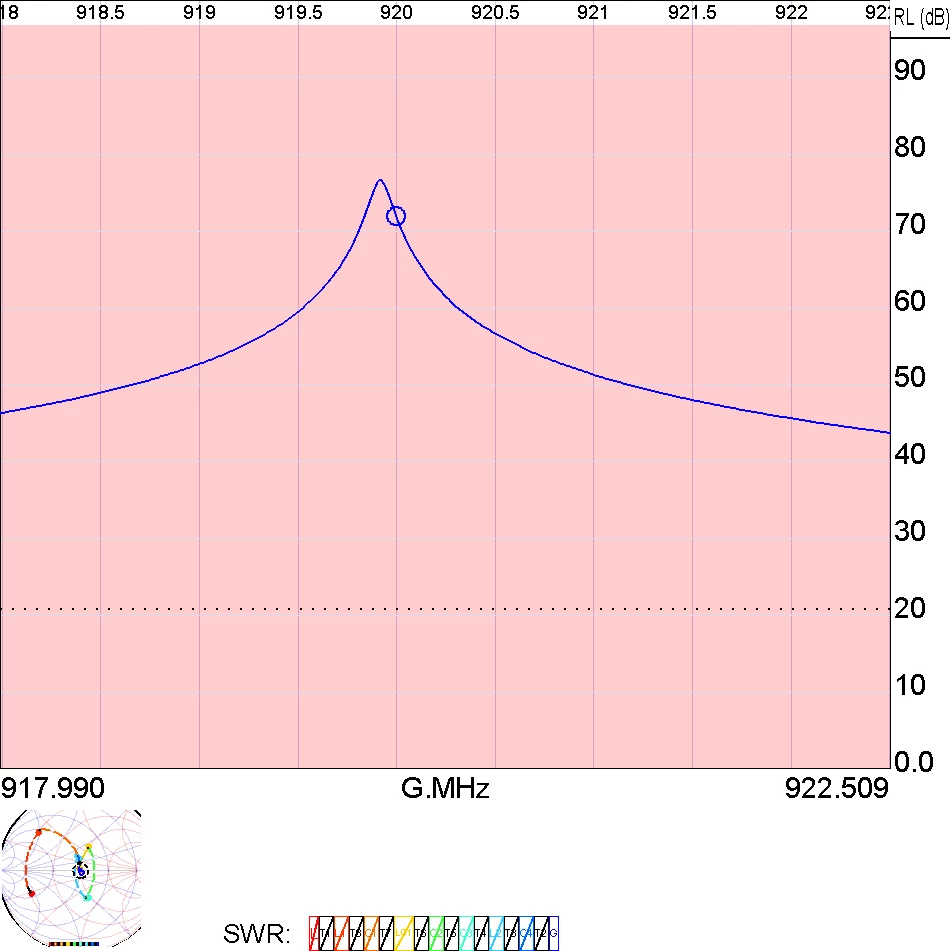

 0693W000006HmLtQAK.pngThis gives a nice result with high RL:

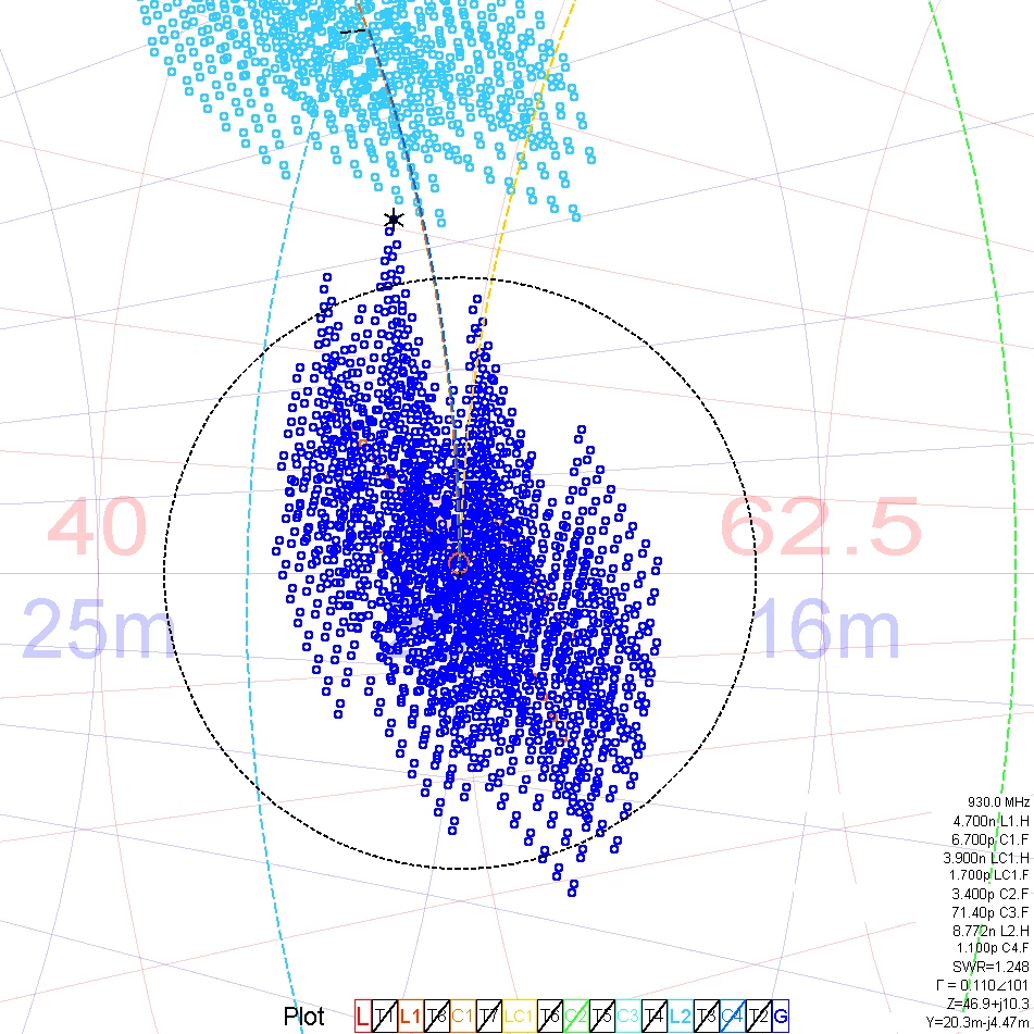

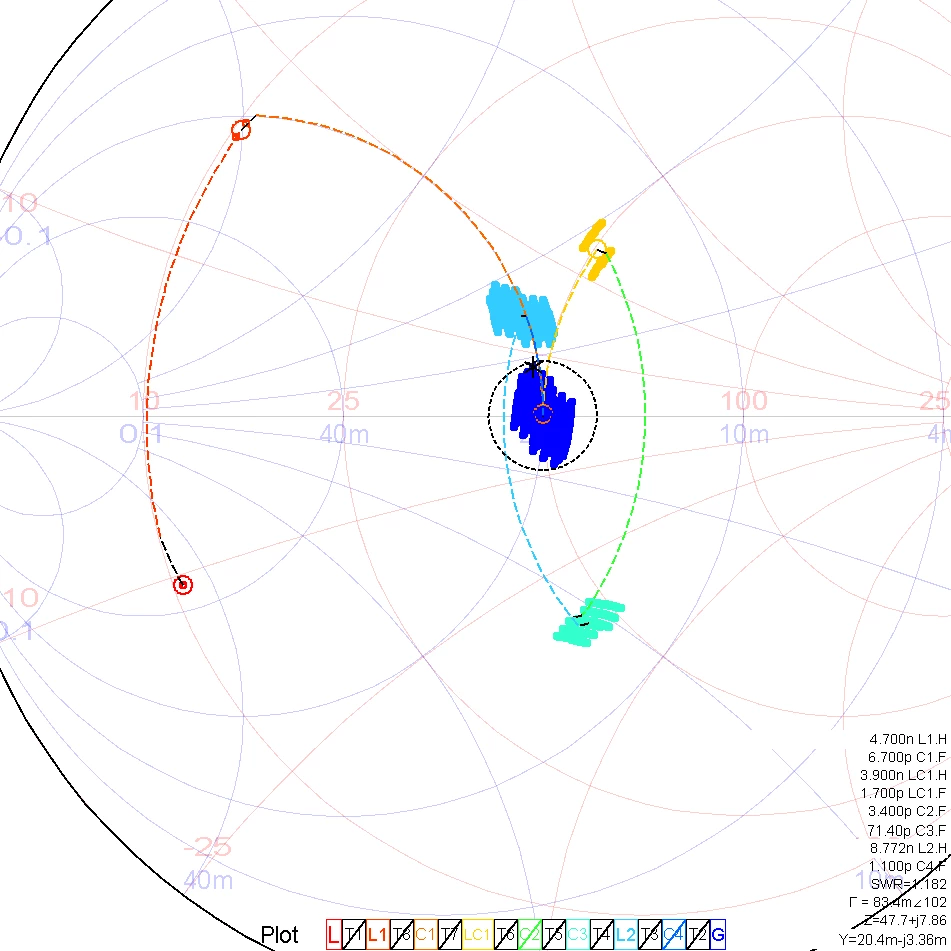

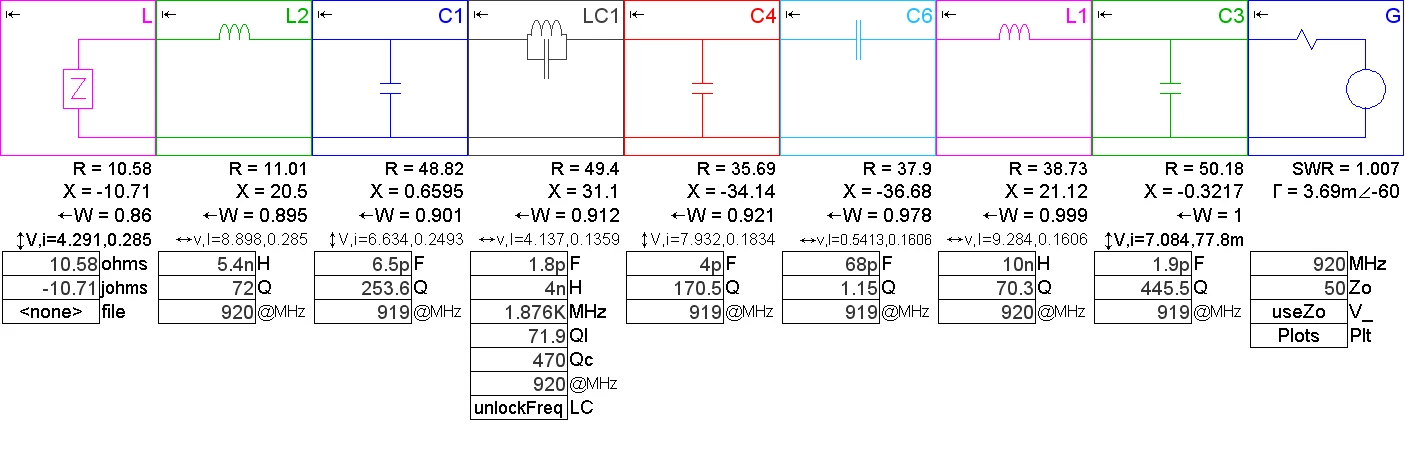

0693W000006HmLZQA0.pngI also wanted to investigate the effect of deviations in the values for the matching network components so I created a sweep simulation for the tolerance value of every component. This creates a smith chart with a "cloud" of possible values at each junction between components which enlarges as it accumulates error while approaching the end point:
 0693W000006HmLPQA0.png With this matching network the VSWR has a maximum of 1.182 with the worst values at 920 MHz and with a sweep from 910 to 930 it only increases to 1.248 for the worst-case scenario:
