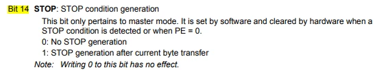

In the manual it says that a stop command will be sent with the next byte if the CR2 stop flag is high.  Is there a way to send a stop command immediately rather than with the next byte?  I'm asking because I have a section of code where I send a start command (with the slave address) and then I repeatedly send data.  I would like to be able to terminate this data loop whenever I need to, rather that needing to write out another byte of data.
6 replies
Feb 4, 2024 9:54 PM UTC
It says after the current byte, not the next byte. If you're not currently sending anything (and clock is stretched), it should be immediate. Are you seeing something different?
Can't send a stop command mid-byte.

I write a byte like this, I observe on a scope that the byte is written and then SCL is held low:
`hi2c->Instance->TXDR = *hi2c->pBuffPtr;`
I then try and issue a stop like this, and nothing happens:
hi2c->Instance->CR2 |= I2C_CR2_STOP;
I then write another byte, which I see on the score, and again set stop bit, and on the SECOND time I set the stop bit I will see the stop flag.  Note that this is during single-step debugging.  So I could post 3 separate scope images if you wanted to see that.
My end-goal is to basically have separate commands to send the start command, an unknown amount of data in a loop, and then a stop command.  Since I haven't yet gotten away from HAL I was trying to do this by making a modified version of HAL_I2C_Master_Transmit which takes an additional argument for which output type you want (start, data, stop).  Because of this I'm using I2C_TransferConfig, and have been playing around with the AUTOEND vs RELOAD modes trying to find a config that worked.  Since I haven't been able to find a mode that works as I liked I was thinking about just manually setting this stop flag.

Just went back to look at my code. Setting STOP immediately sends a stop condition for me. No need to send a new byte.
I2C_TransferConfig isn't meant to be called directly and does a lot of other things other than just setting STOP.
