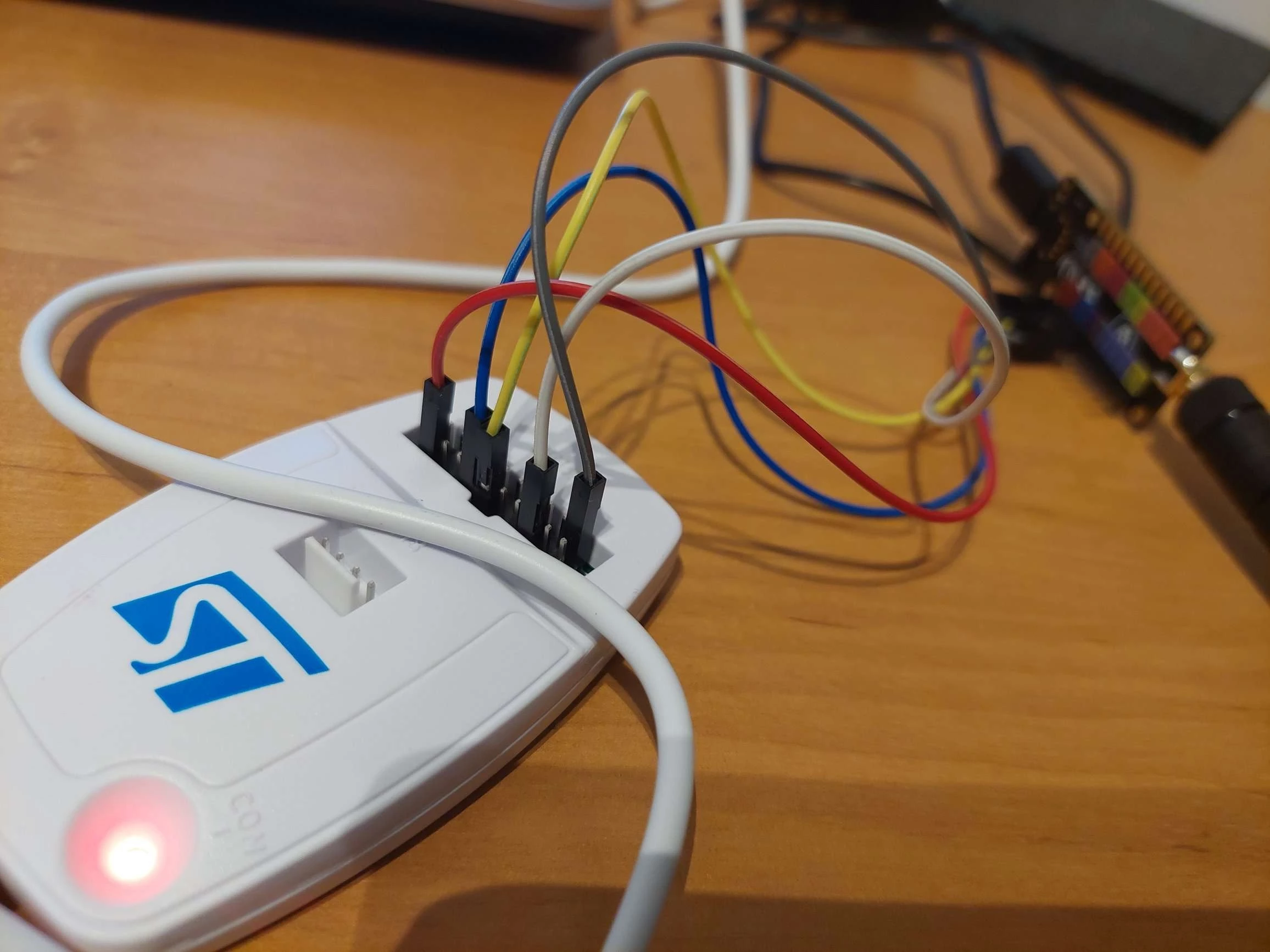

I attached wires as you mentioned.
0693W00000Y8nyHQAR.jpgI pressed on Rest button on the WIO-5 Mini. Having this button pressed, I clicked on Connect button (having ST-LINK selected from the list).
0693W00000Y8nz0QAB.jpgNothing changed. I ST-LNIK didn't recognize WIO-5. What am I missing?

The serial number suggests it is a bootleg ST-LINK/V2
The power should only be 3.0 to 3.3V, yours looks to be reporting pushing 5V
Sorry, can't see the WIO-5 side connectivity, not in focus.
Choose Hardware Reset, and connect under reset..

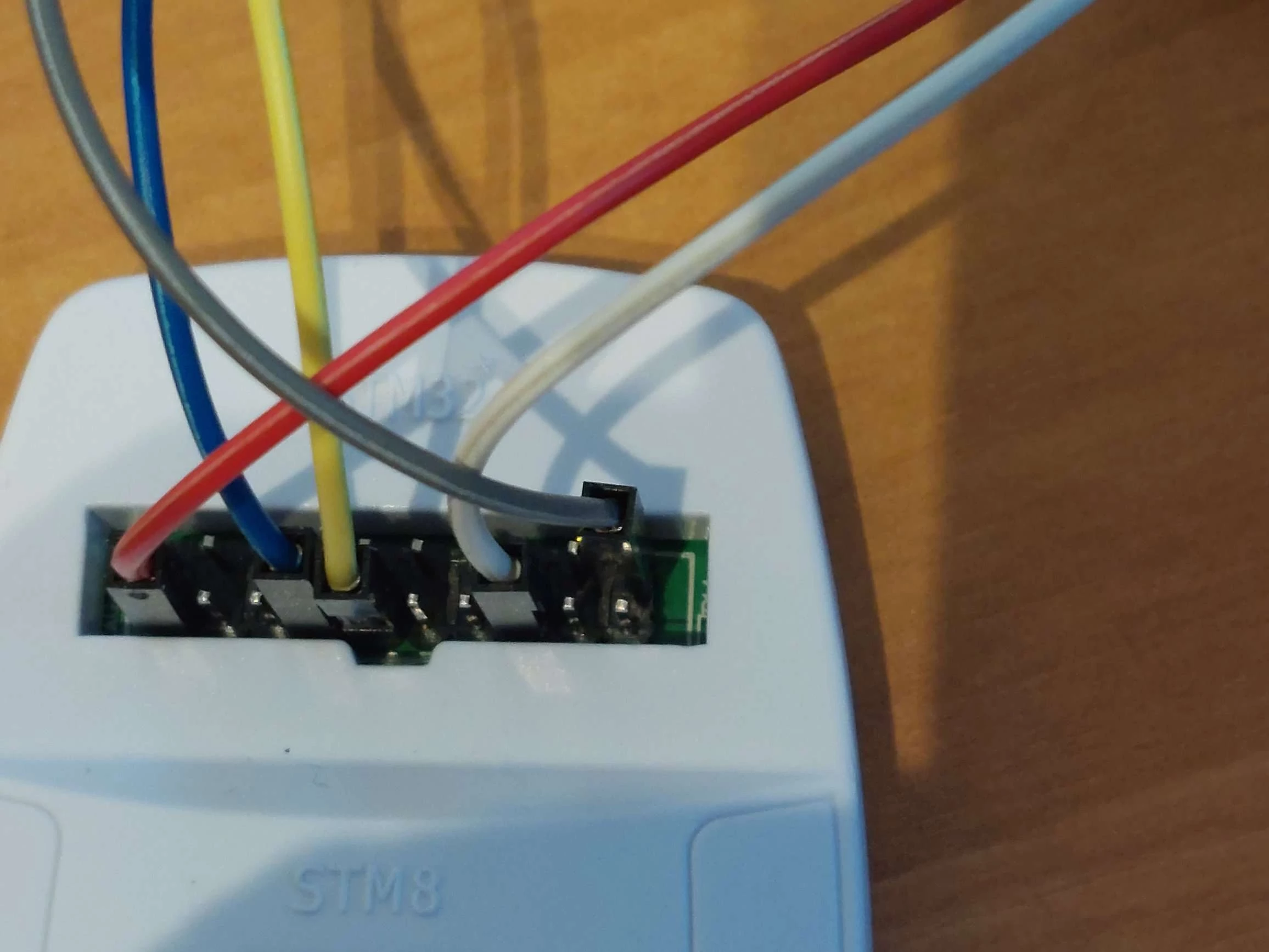

So I will show you a little bit closer.
First view of ST-LINK connections
0693W00000Y8p33QAB.jpgAs you can see:
  1. red -VCC
  2. blue - SWDIO
  3. yellow -SWCLK
  4. white -NRST
  5. gray - GND.

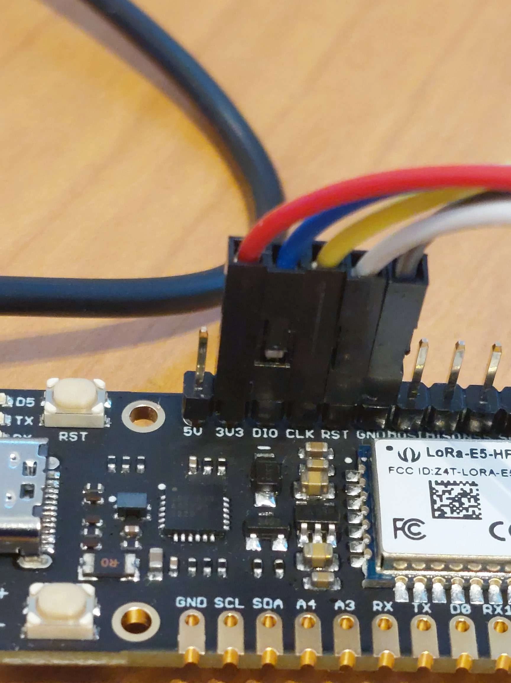

Next view of connections to WIO-5 Mini board:
  1. red - 3.3V
  2. blue - DIO
  3. yellow - CLK
  4. white - RST
  5. grey - GND.
Having these connections, I press the Reset button on the WIO-5 mini board and hold it. Next, I click on the button Connect on the STM32 Cube Programmer window. It still doesn't recognize my WIO-5 Mini board.
Maybe these pieces of information will be helpful. WIO-5 mini is a brand new one. It was never programmed using STM-LINK or any other bootloader tool.
I expected it to be elementary, as for programming with Arduino IDE. But still have strange problems with the WIO-5 MIni board and ST-LINK.
PS. I can send AT commands to this board using Termite, in my case. It responds properly. So it works and is alive.

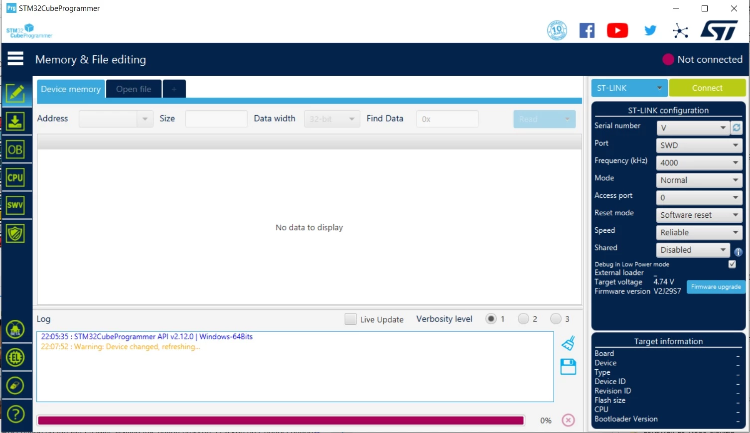

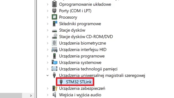

Maybe it will be helpful. I read the documentation of STM-LINK and found that I can check if my installation is proper. I run such a command:
STM32_Programmer_CLI -l usb
I got an unexpected result:
0693W00000Y8pGCQAZ.jpgBut I see ST-LINK in the device manager
0693W00000Y8pGHQAZ.jpgI see it under the option Universal Serial Bus Devices and DM says that it works properly.

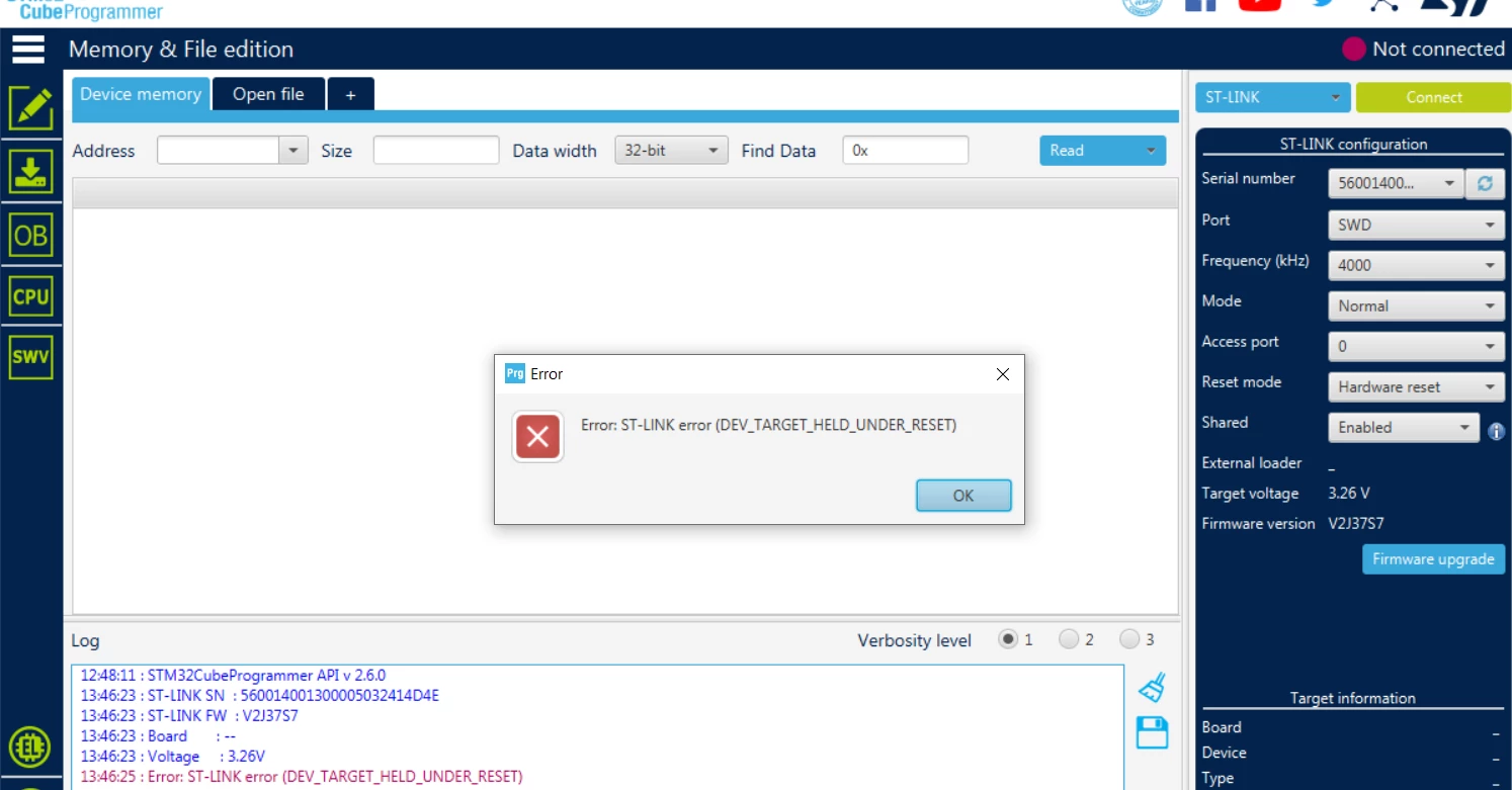

Jan 22, 2023 8:22 AM UTC
Something is wrong. ST-LINK doesn't see the WIO-5 mini-board.
0693W00000Y8qLhQAJ.pngI link the WIO-5 board to the STM32 by wires as is in the above pictures. I don't see any mistakes in the connections.

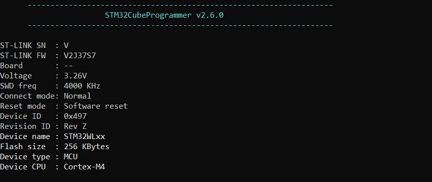

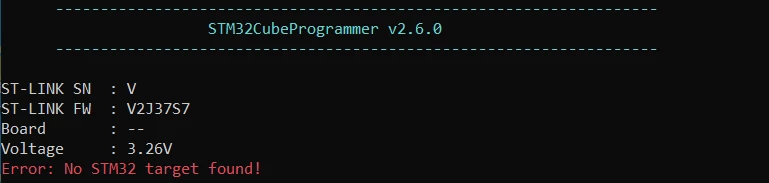

I applied a note from Drew from this thread How to fix STM32 Stuck with error ST-LINK error (DEV_TARGET_NOT_HALTED) - Electrical Engineering Stack Exchange and I got an answer:
0693W00000Y8qVSQAZ.pngAnd it is exactly my STM chip discovered.
But I still have this:

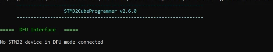

Jan 22, 2023 12:19 PM UTC
After several tries (button Boot pressed or PB13 connected to GND, VSS, or VCC) my WIO-5 mini doesn't respond on AT commands. So I guess that it isn't already in AT mode but still isn't in DFU mode.

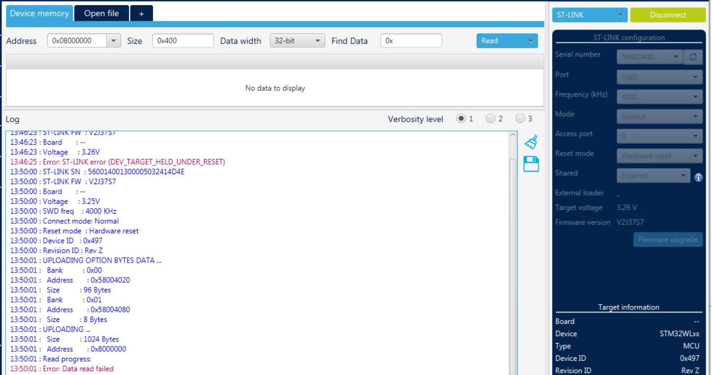

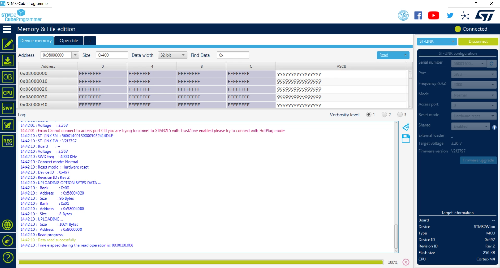

What a stupid thing!
The command line shows that this board requires a software reset. I changed the reset mode to the hardware reset and shared it to enable, pressed, and hold the button Reset on the board, and I clicked on the Connect button in the STM32Cube Programmer IDE and...
0693W00000Y8qeeQAB.pngEvery source on the Internet mentions that the reset button should be held until clicking on the Connect button. So I click on the reset button and release it, and next click on the Connect button, and viola...
0693W00000Y8qeoQAB.pngI think a little bit closer to my target now.
markpow
markpowAuthor
Senior
Jan 22, 2023 1:58 PM UTC
It's the final cut and the end of the story (but I have to change Read Protection Level to AA - no protection):
0693W00000Y8qiMQAR.pngMy WIO-5 board is ready for programming now (I hope :) )
