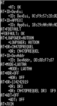

I have a pnucleo lrwan3 kit and I'm trying to setup the end node using the LRWAN NS1 AT Master example from I-NUCLEO-LRWAN package.
Everything is working fine until the program gets to the AT+DR command. There a Hard Fault occurs and it gets stuck in a forever loop (default handler).

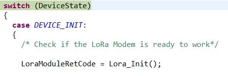

I tried to isolate the problem using the debugger. When the program reaches the switch(DEVICE_STATE) statement, the hard fault occurs. The problem is that I can't get the debugger to enter this switch statement, but it does enter, as various AT commands are being printed after the switch, and before the hard fault.

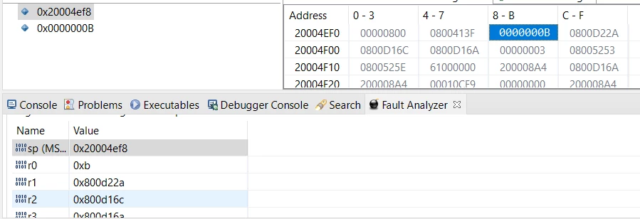

I tried to get infos on this hard fault, but the analyzer does not provide me any clue. I can only get the SP register value and I have not enough knowledge to get any useful info out of it.

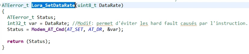

Found a solution !
Apparently for no reason, it can crashes on the AT+DR command. To solve the issue, you just have to change the Lora_SetDataRate() function as follow :

I tend to use a HardFault Handler that outputs actionable data. https://github.com/cturvey/RandomNinjaChef/blob/main/KeilHardFault.c
You look at a disassembly of the specific instruction faulting, and those immediately prior, and you do so in the context of the CPU registers. You can then back-fit that into your C code, and the structures, and variables it's working with. Identify the potential culprits, and then add sanity checking code around them so you know pointers etc have valid/expected values, and if they are wrong due to initialization or corruption.
Make sure to explicitly clear local/auto variables.
Try with different optimization.
Watch for appropriate use of volatile variables.

Found a solution !

>>Apparently for no reason...
No, for a reason you haven't established.
Looks to be alignment, or access via the pointer modifies something out of scope.
Might see similar errors for sscanf()
