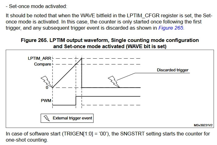

Try setting up WAVE bit in the LPTIM CFGR register to activate the set once mode (Fig 2).
Also for the delay : Fig 1

Another plausible reason as to why it starts in continuous mode, you use the following function : HAL_LPTIM_TimeOut_Start_IT()
And when you take a look at the function definition there is : __HAL_LPTIM_START_CONTINUOUS(hlptim); in it. So you might want to use : HAL_LPTIM_SetOnce_Start instead.
Read here : http://www.disca.upv.es/aperles/arm_cortex_m3/llibre/st/STM32L486xx_User_Manual/group__lptim__exported__functions__group2.html#ga58a5c04b69996ada2493b5ba943902a0
