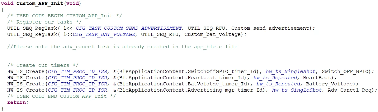

In a nutshell I have created three timers and two tasks.
When the Heartbeat timer expires it calls the Heartbeat function:

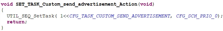

This then sets a tasks:
This then runs the Advertisement function

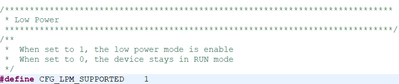

When I set the CFG_LPM_SUPPORTED to 1 the problems come up

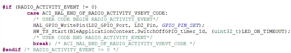

Firstly the timers seems to be functional. However the LD2 (Green LED) which comes on when the radio activity event is called does not gets called. Because the LD2 never comes on. This is found here in the SVCCTL_UserEvtFlowStatus_t SVCCTL_App_Notification(void *p_Pckt) function:

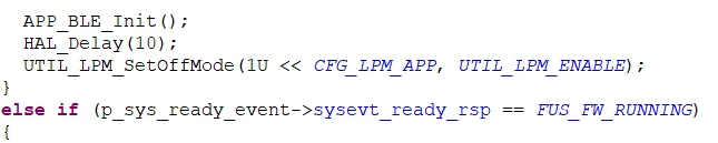

The only thing that sorts of solves my issues is by adding a delay in the
static void APPE_SysEvtReadyProcessing(void * pPayload).
Please note if I change CFG_LPM_SUPPORTED back to 0 then everything works perfectly.
