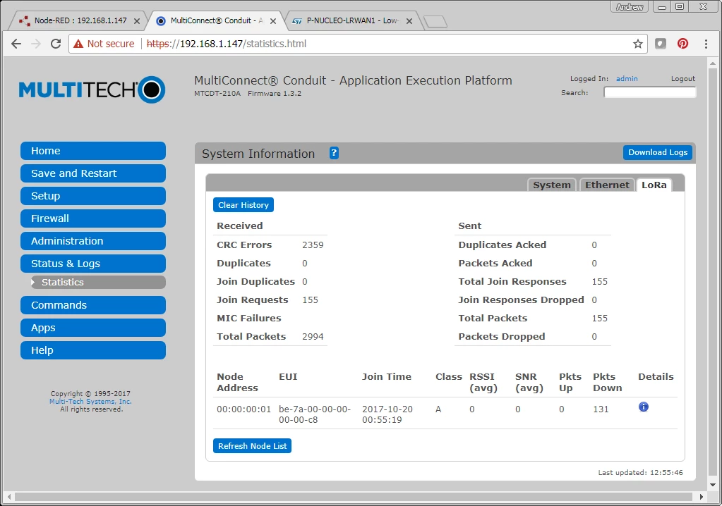

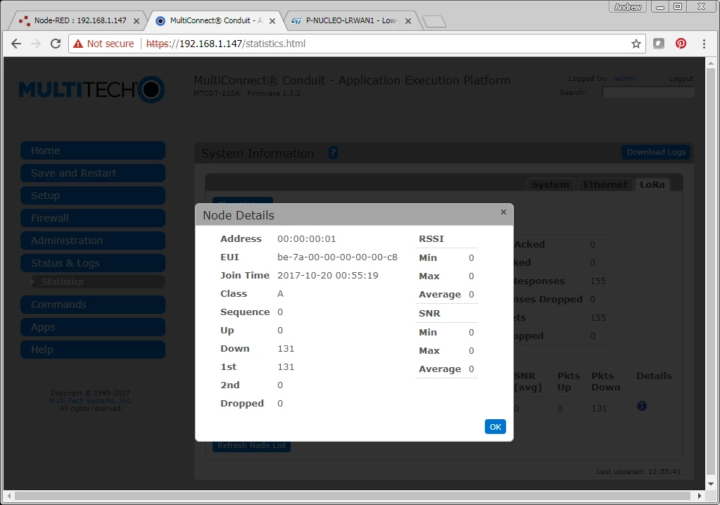

The Conduit sees the board as ''Joined'', but the Node-RED does not see any incoming data.
I don't see any ''JOINED'' message in the UART output from the board (the video shows one, but the UM2073 documentation says nothing about what should currently be expected on the UART).
Using the 'Download Logs' from the Conduit, the messages log contains stuff like:
Oct 20 08:03:18 mtcdt user.info lora-network-server: Parsing 1 rx packets
Oct 20 08:03:18 mtcdt user.info lora-network-server: Received join request
Oct 20 08:03:18 mtcdt user.info lora-network-server: Device found in DB, assigning address: 1
Oct 20 08:03:18 mtcdt user.info lora-network-server: Queue join response 33 bytes
Oct 20 08:03:18 mtcdt user.info lora-network-server: Send Join Accept - EUI: be-7a-00-00-00-00-00-c8 ADDR: 00000001
Oct 20 08:03:18 mtcdt user.info lora-network-server: Schedule TX Time on air: 81 ms
Oct 20 08:03:19 mtcdt user.info lora-network-server: Frame transmitted to 00:00:00:01 via GW (00:80:00:00:a0:00:05:a8 Chan LC2 127.0.0.1:34778) Seq♯ 0
Oct 20 08:03:19 mtcdt user.info lora-network-server: Update DC Band: 1 Duration: 71 time-on-air available: 35929 ms
Oct 20 08:03:19 mtcdt user.info lora-network-server: Transmit UDP message to Gateway 208 bytes
Oct 20 08:03:48 mtcdt user.info lora-network-server: Parsing 1 rx packets
Oct 20 08:03:48 mtcdt user.warn lora-network-server:
Recv'd frame failed CRC check
Oct 20 08:03:49 mtcdt user.info lora-network-server: Parsing 1 rx packets
Oct 20 08:03:49 mtcdt user.warn lora-network-server:
CRC errors would explain why the received data is not being seen.
So: has anyone actually got this working with a Conduit gateway using the current firmware?
The fact that the behaviour is the same for the 2 boards suggests that it's a configuration issue rather than a HW fault.

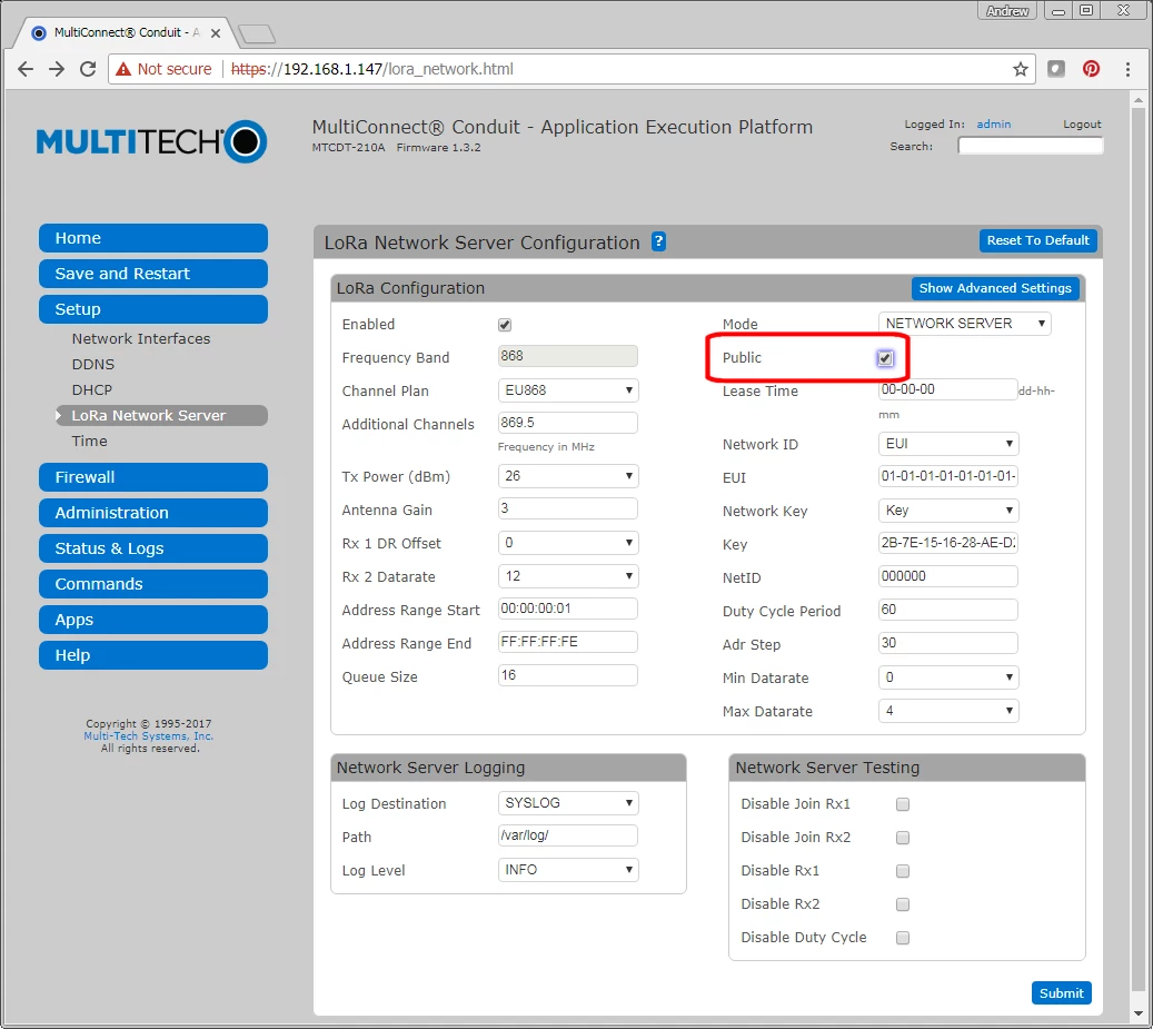

The key thing that I'd missed (which is shown in the video) is that the Conduit's LoRa Network Server must be set to Public:
With that, I do now see 'JOINED' in the STM32 UART output, and there is something being received in the Node-RED - although it is currently barfing on it ...

For info, MultiTech's documentation says:
'Enable public compatibility mode: changes the join response time from 1 to 5 seconds and the sync word from 0×12 to 0×34'
http://www.multitech.net/developer/software/lora/conduit-aep-lora-communication/conduit-aep-advanced-lora-network-server-configuration/
In the I-CUBE-LRWAN code, commissioning.h has:
 * Indicates if the end-device is to be connected to a private or public network
#define LORAWAN_PUBLIC_NETWORK true
and the sx1h and sx1h files have:
 * Sync word for Private LoRa networks
#define LORA_MAC_PRIVATE_SYNCWORD 0x12
 * Sync word for Public LoRa networks
#define LORA_MAC_PUBLIC_SYNCWORD 0x34
