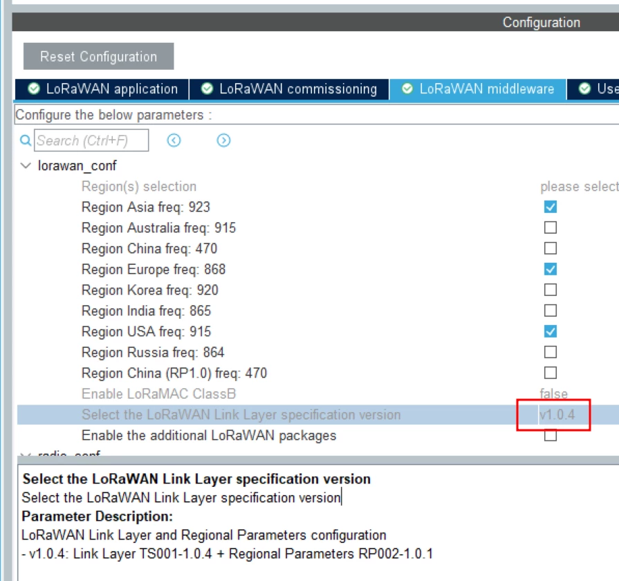

RusikOk
Aug 8, 2026 6:48 PM UTC
Hello! I’ve come across the same problem. The versions of my libraries are:
APPLICATION_VERSION: v1.6.0
MW_LORAWAN_VERSION: v1.1.0
MW_RADIO_VERSION: v1.5.0
In the `smtc_secure_element_process_join_accept` function in the `soft_se.c` file, I see the following code:
    // Verify mic
if( *version_minor == 0 )
// For LoRaWAN 1.0.x
// cmac = aes128_cmac(NwkKey, MHDR | JoinNonce | NetID | DevAddr | DLSettings | RxDelay | CFList |
// CFListType)
if( smtc_secure_element_verify_aes_cmac( dec_join_accept, ( enc_join_accept_size - LORWAN_MIC_FIELD_SIZE ), mic,
SMTC_SE_NWK_KEY, stack_id ) != SMTC_SE_RC_SUCCESS )
return SMTC_SE_RC_FAIL_CMAC;
else
return SMTC_SE_RC_ERROR_INVALID_LORAWAM_SPEC_VERSION;
In other words, the v1.1.0 libraries do not support JOIN in version v1.1.0, which is very strange! So I switched the LoRaWAN version in the device settings and received the message “Event received: JOINED Modem is now joined”
I don’t know if you’re supposed to do it like that for a production
RusikOk
Aug 8, 2026 10:10 PM UTC
although the STs did intend to warn us:
Aug 31, 2026 11:16 AM UTC

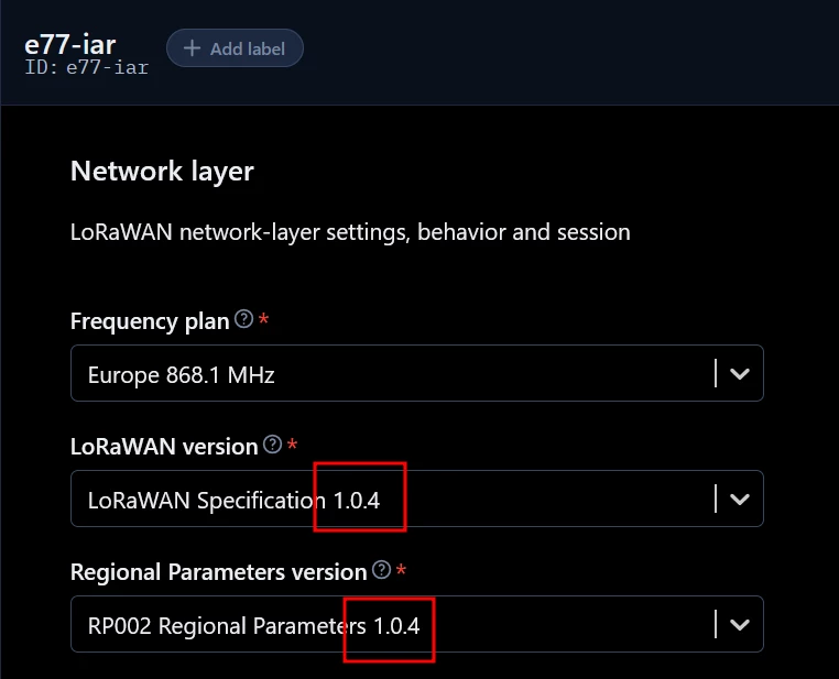

Hello ​@lcordier
Which is the complete configuration used both on LoRaWAN_End_Node_LBM and on Chirpstark?
Just to clarify, the following versions are:
  • Application: LoRaWAN_End_Node_LBM (V1.6.0)   -> App version
  • Middleware (MW) LoRaWAN: V1.1.0      -> LoRaWAN MW FW version
  • Middleware (MW) Radio: V1.4.0             -> Radio MW FW version
  • L2 Spec: V1.0.4          -> LoRaWAN Specification version v1.0.4
  • RP Spec: V2-1.0.4      -> Regional Parameters Specification version vRP002-1.0.4
So the LoRaWAN Specification version is v1.0.4 NOT v1.1.0.
Sep 22, 2026 2:44 PM UTC
Hi ​@lcordier ,
Do you have update on this issue?
Could you please share your configuration used both on LoRaWAN_End_Node_LBM and on Chirpstark?
