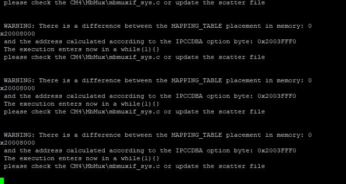

I'm using Nucleo-WL55JC1 STM32WL development board for LoRaWAN end node dual core and i have a custom board with MCU STM32WLE5CBU6 for LoRaWAN end node single core.
I have configured LoRaWAN end node protocol parameters like this documentation (https://www.st.com/resource/en/application_note/dm00660451-how-to-build-a-lora-application-with-stm32cubewl-stmicroelectronics.pdf).
The program from the example project has been uploaded successfully. After I uploaded the LoRaWAN end node program to the STM32WL55JC1 (dual core) development board, it said
"WARNING: There is a difference between the MAPPING_TABLE placement in memory: 0x20008000
 and the address calculated according to the IPCCDBA option byte: 0x2003FFF0
 The execution enters now in a while(1){}
 please check the CM4\MbMux\mbmuxif_sys.c or update the scatter file"
on the external terminal via serial usb and couldn't send data to the server / gateway with OTAA. I have followed the solution steps given from this topic:
(https://community.st.com/s/question/0D53W00000VgqmvSAB/trouble-with-the-stm32cubewl-dual-core-example-projects)
and I still have problems like that
Meanwhile, for the single core STM32WLECB MCU end node, the program was successfully uploaded with the Lora protocol configured. But there is no response / action from the node sending data to the server / gateway with OTAA. On this board, I'm not using TCXO and DCDC.
So, from the problem I got, is there a solution or configuration that I missed so that the nodes can send data with OTAA to the server / gateway with dual core or single core. I really appreciate your attention, thank you.

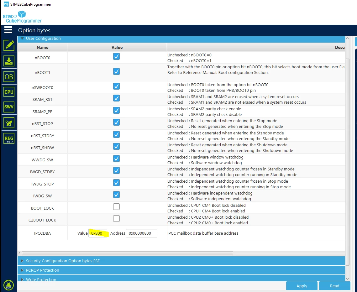

YBOUV.1
Apr 20, 2021 2:54 PM UTC
as you saw in the thead (https://community.st.com/s/question/0D53W00000VgqmvSAB/trouble-with-the-stm32cubewl-dual-core-example-projects))
the option byte IPCCDBA probably does not match MAPPING_TABLE address in the linker file at STM32CubeIDE\CM4\STM32WL55JCIX_FLASH.ld.
  • MAPPING_TABLE is mapped at RAM_SHARED (@0x20008000). Mapping table is used to exchange data between the cores.
  • To see IPCCDBA, connect with cube programmer, open tab 'OB', section 'User Configuration', scrolling down to bottom you will find it.
following rule shall apply IPCCDBA = (MAPPING_TABLE>>4)
please try to program manually option byte IPCCDBA to 0x800. The board will restart to reload the new OB value.
To do this, please connect with CubeProgrammer, go to 'Option Bytes/User Configuration 'tab and scroll down to IPCCDBA. Then update IPCCDBA to 0x800.
The board should reset and M0 should now boot.

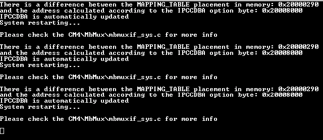

Hi @Candra SN.​  have you been able to resolve all your issues with LoRa communication? if yes can you share what you did. im having the same issues with dual core on my board. i ran the single core example smoothly from this Tutorial (MOOC - STM32WL workshop - 5 Sending data to LoRaWAN network lab - YouTube) on both nucleo board and my manufactured board, but Dual Core example is not working and i cant seem to find a decent tutorial for dual core

i have the exact same issue i did the fix suggested from the cube programmer but it did not fix the issue
after reboot i still have this message
"There is a difference between the MAPPING_TABLE placement in memory: 0x20000290
IPCCDBA is automatically updated"
