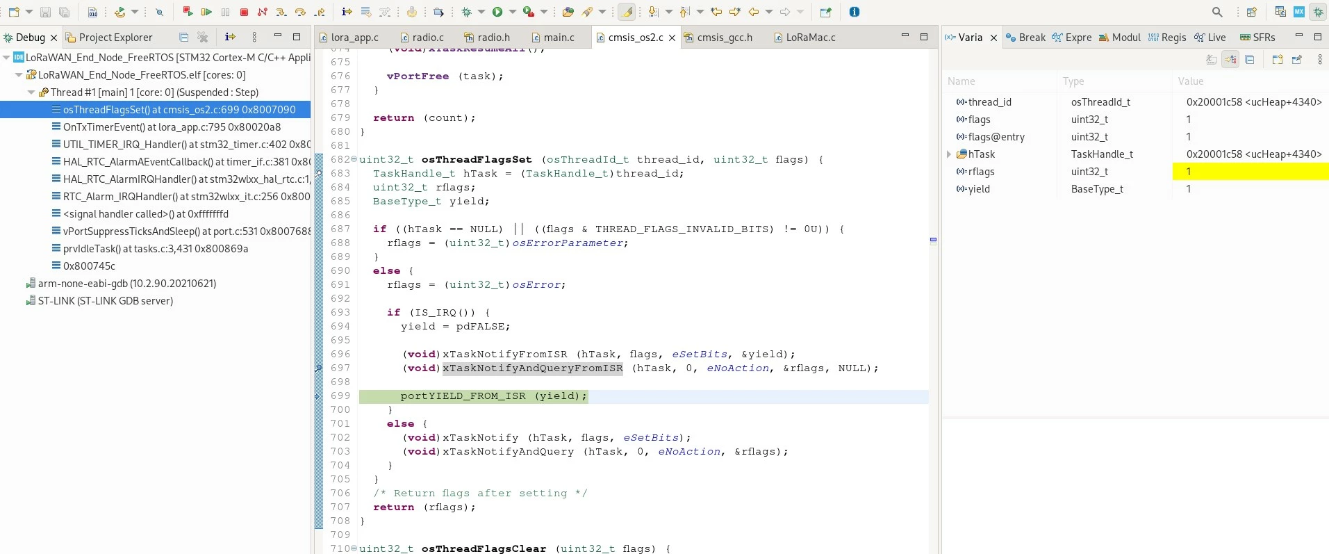

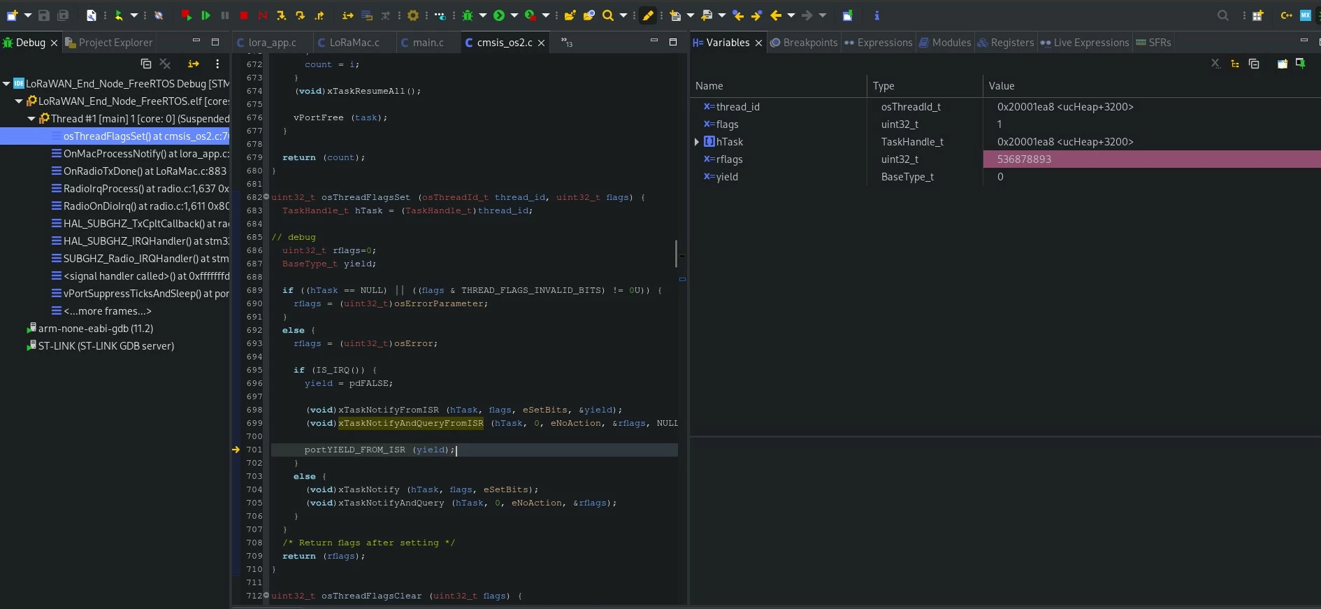

@Louis AUDOLY​ I found the difference in program flow of st example and project generated by me from .ioc file. Inside lora_app.c file there is Task which waits for setting ThreadFlag. After flag being set LmHandlerProcess() is called.
static void Thd_LmHandlerProcess(void *argument)
 /* USER CODE BEGIN Thd_LmHandlerProcess_1 */
 /* USER CODE END Thd_LmHandlerProcess_1 */
 UNUSED(argument);
 for (;;)
 osThreadFlagsWait(1, osFlagsWaitAny, osWaitForever);
 LmHandlerProcess(); /*what you want to do*/
 /* USER CODE BEGIN Thd_LmHandlerProcess_2 */
 /* USER CODE END Thd_LmHandlerProcess_2 */
The only place where flag can be set is OnMacProcessNotify() callback. After successful Join Procedure first data packet is being sent. When Radio ends transmission OnRadioTxDone() callback (LoRaMac.c) is called. Inside OnRadioTxDone function MacProcessNotify( ) is executed which leads to OnMacProcessNotify() and setting the flag. The difference apears inside osThreadFlagsSet() function (cmsis_os2.c). In working example after (void)xTaskNotifyAndQueryFromISR (hTask, 0, eNoAction, &rflags, NULL); (line 697) variable rflags is set to 1.
In my project this variable has some random value I believe so there is the problem with unblocking the Thd_LmHandlerProcess task.
0693W00000Nr6wJQAR.jpgSo the question is, why is that? Configuration of FreeRTOS in .ioc is exactly the same and also all of the files inside FreeRTOS middleware directory are the same. What might be possible solution, what might be causing the issue and where should I go further with my debugging?

Louis AUDOLY
Jun 7, 2022 9:34 AM UTC
Hello @Community member​ ,
The two screenshots you share don't show the same call stack so we cannot compare the value of rflag here.
Then do you have the same version of FreeRTOS and CMSIS on your personal project and ST example ? (the following screenshot is taken from CubeMx)
Do you have the same include path to CMSIS, middleware etc... between the two projects as you seems to have two different environments ?
Regards

@Louis AUDOLY​ I'm working with CMSIS v2 and FreeRTOS in version 10.2.1. Include paths are the same. Difference in environments color mode is because of that I was using two different workspaces to be able to compare projects side by side. Attached you will find invalid project so you can test it and see how it acts. In the project all of the files are replaced with example files but anyway program execution is different.
