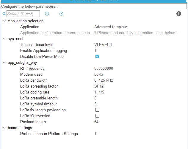

I try to build up a HAM LoRa APRS system with STM32 and I don´t receive any messages in my gateway. For testing purposes, I use an 868 MHz gateway and an RAK3172 module. The RAK3172 module is configured as shown below:
Initialize the LoRa module (use 868 MHz for testing)
- Frequency: 868 MHz (868000000)
- Spreading Factor: 12 (12)
- Bandwidth: 125 kHz (0)
- Code Rate: 4/5 (0)
- Preamble Length: 8 (8)
- Tx Power: 14 dBm (14)
AT+NWM=0
AT+P2P=868000000:12:0:0:8:14
Transmit a coordinate point via APRS
- Header: <FF01
- Payload: DO2DKH-7>APLG01:!4932.05NL01047.50E&Test
AT+PSEND=3CFF01444F32444B482D373E41504C4730313A21343933322E30354E4C30313034372E353045265465737432
After transmitting the message via "PSEND" I receive it in my gateway
Received packet 'Source: DO2DKH-7, Destination: APLG01, Path: , Type: Position Without Timestamp, Data: !4932.05NL01047.50E&Test2' with RSSI -40dBm, SNR 11.75dB and FreqErr 17145.003906Hz

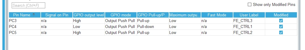

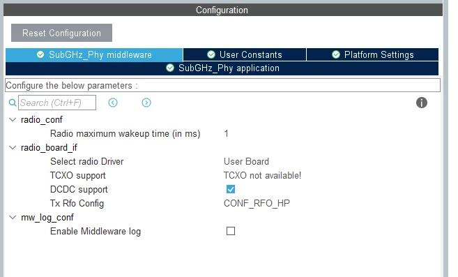

I tried the same with my STM32WL55-Nucleo. I configured the RF switch pins for HP usage
and the SubGHz middleware with the LoRa settings
Then I use the following code to transmit a test message after the initialization of the SubGHz middleware

But I don´t receive the message with my gateway and "OnTxDone" isn´t called despite a successful transmission indicated with "RADIO_STATUS_OK" in "status".
What is missing here?

Jan 6, 2024 5:27 PM UTC
Hi @STTwo-32,
the LoRaWAN examples aren´t the right ones, but I used the SubGhz_Phy_PingPong example for transmission and it works.
