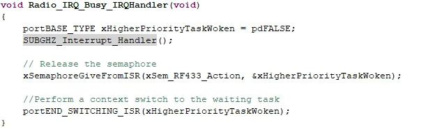

I finally found that the lack of detection is not due to Lora configuration.
but my receiver (I dont know why) receive a hardfault interruption after receiving !
it is not the case for the transmitter
I always need your help, maybe i have messed something in receiver config !

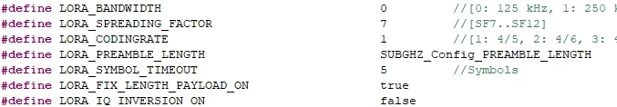

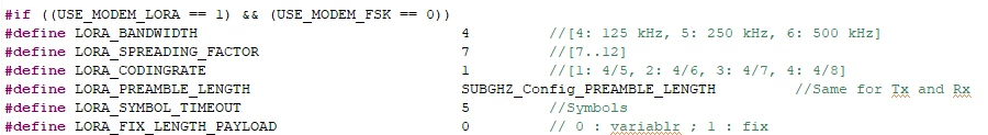

last update after multiple debugging :
1 - when i set fix payload length in tx and rx config, i have a crc error in detected frame, i detect wrong data, than a hardfault.
2 - when i set variable payload length, i don't have the hardfault, but a cannot detect all frame (less then 1% are detected) and when i detect, i usually have a header error
i set the same config for the transmitter and the receiver.

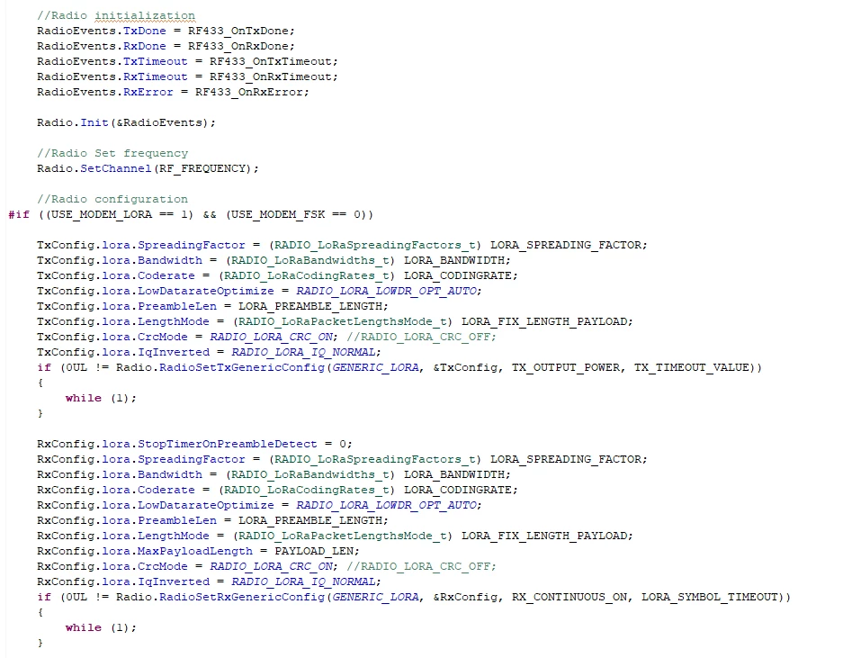

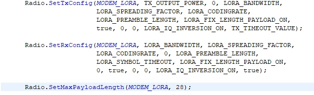

malarabAuthor
Senior
Aug 22, 2022 1:21 PM UTC
I tried to configure lora modulation on an other way, but always the same problem !
pleas find the code below
