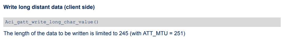

Just trying to figure out the max size I can pass to the write function.
According to AN5289 :
Write long distant value
aci_gatt_write_long_char_value(conn_handle, RxCharHandle,offset, chunk_size, (&payload)+offset)
Max data write length is 243 bytes.
Is it correct or can I pass larger values?
1 reply
Remy ISSALYS
November 7, 2022
Your revision of AN5289, it's an old revision, please refer to AN5289. According to programming manual PM0271, you can write data up to 245 bytes:
