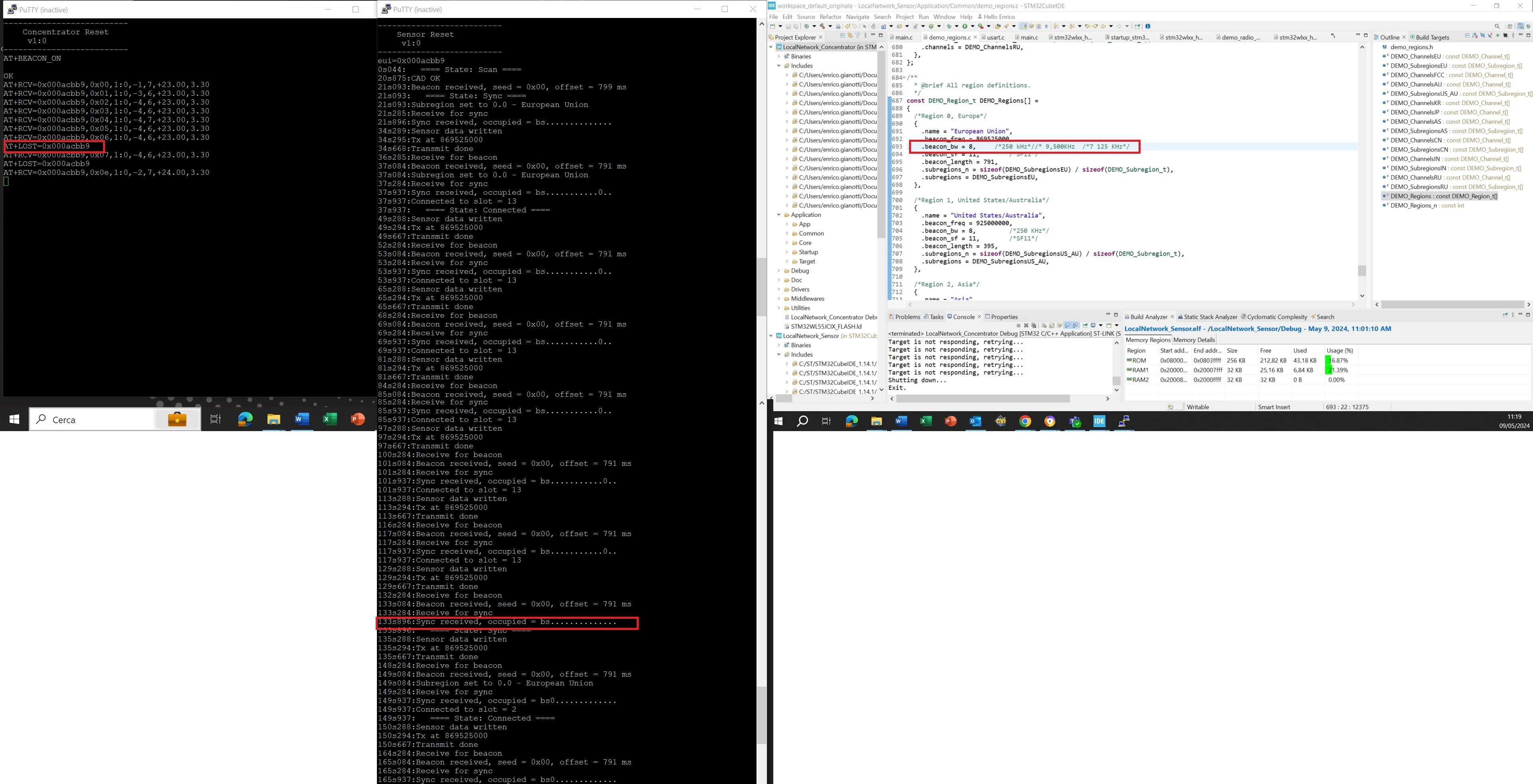

Good morning,
I am using two NUCLEO WL55JC1 development boards and the LocalNetwork_Sensor and LocalNetwork_Concentrator example that I found in the development software provided by ST. When I use a frequency band of 868MHz and a bandwidth of 125 KHz there is no problem, but when I use a bandwidth of 250KHz or 500KHz there is a problem. The issue is that after 6 receptions from the Sensor by the Concentrator, the Concentrator not recognize the Sensor and generates LOST message. Can someone help me? Thank you

Hello @Henry77
It seems to work fine on my side. Could you send your two projects with the changes you made.
Best Regards.
