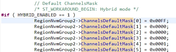

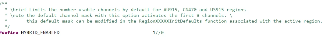

I noticed that while it attempts to send every 10s, it sends it to channels that our gateway does not use. I found that I can turn on Hybrid_mode in the file lorawan_conf.h to limit the channels to 1-8 but this does not allow my device to join as our gateway is only limited to 8-15.
I then found that we can change the channels default mask to properly adjust for channels 8-15 in the file RegionUS915.C.
However, while I was searching on what to properly set it as, I came across someone mentioning to that the device can't be certified if we plan on making changes the default masks (link).
This product needs to be certified so how would I be able to limit the channels used on my end node? I would like the data to only be sent to the proper channels as I would be missing some data every 30 minutes. I also can't increase the frequency at which it sends data as this drains the battery tremendously.

Gateways tend to use different chips that can concurrently receive multiple channels, and be able to receive and transmit at the same time, with assorted bandwidth and spread factors, etc. ie SX130x devices, rather than SX126x half-duplex, single channel, ones.
Compliance, perhaps you support multiple modes of operation with the primary REGION setting matching those of the GATEWAY, and a power saving one that searches a more limited subset, via the masking, or one that can be set to a specific channel the gateway is parked on or monitoring?
