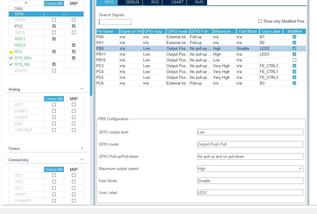

Hello, i just bought a STM32WL55JC2. It's working perfectly on Arduino but i want to use the LORA module and Arduino doesn't support it.
I've configured my stm on CubeMX and tried a basic HAL_GPIO_WritePin but it doesn't work and i can't figure why.

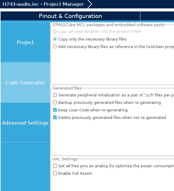

yea, but i see: _MODER shows 0xFFFF... -> pins are on analog mode !!!!! so no hi/lo output.
where you set it analog? check!

0693W00000WIHuyQAH.jpgi generated the code automatically so i didn't change anything. I don't know how to change this.
AScha.3
AScha.3Best answer
Nov 14, 2022 3:56 PM UTC
check: did you
x set free pins as analog ?
to test : just write
GPIOB->MODER = 0x55555555 ;
while ....set pin .... .
BNamu.1
BNamu.1Author
Nov 14, 2022 4:04 PM UTC
Nop this parameter isn't enable. BUT with GPIOB->MODER = 0x55555555 ; my led is now working !!! Thank youu, i still don't know why my pins are on analog mode but it's fine
