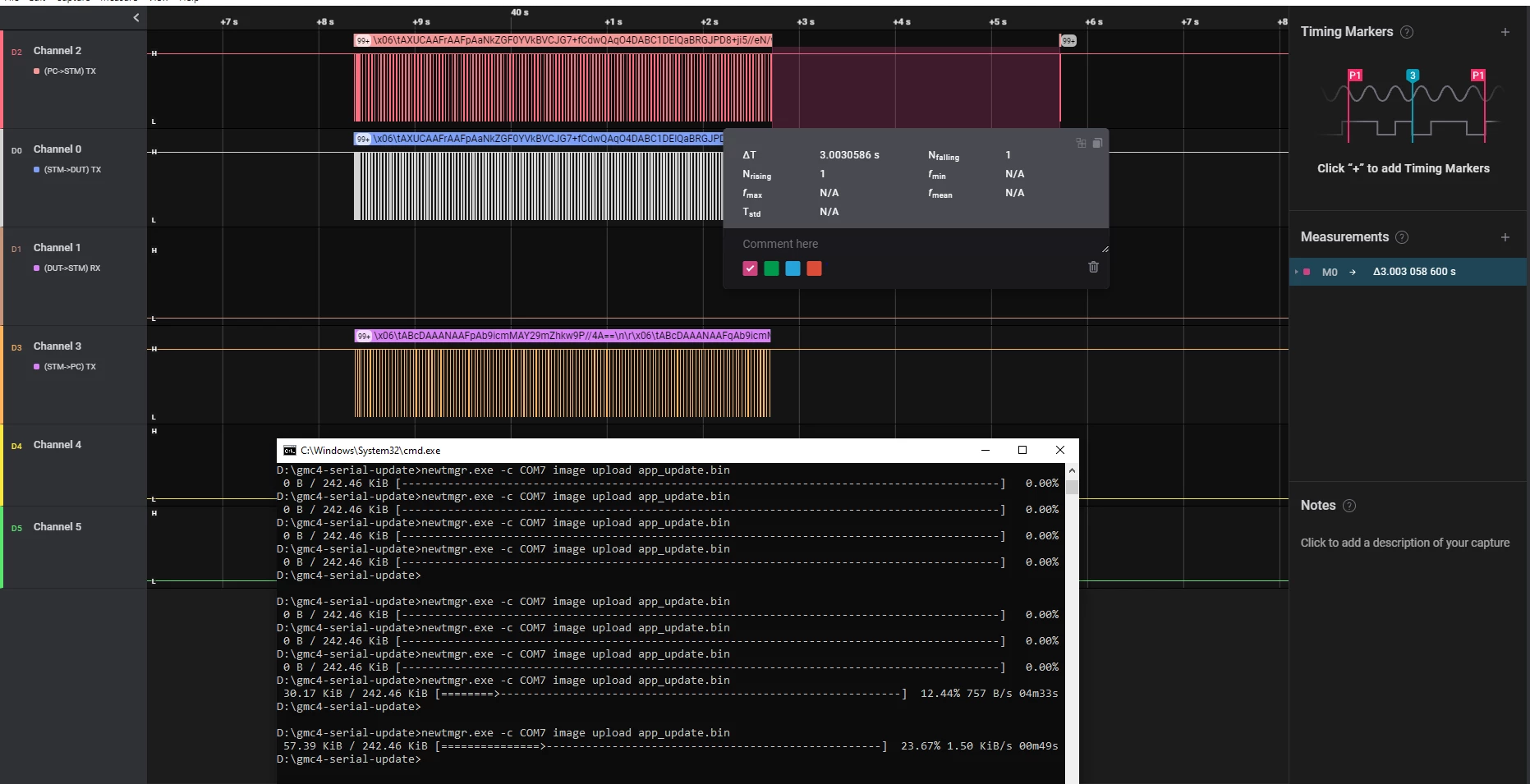

I am working on a project where the stm must act as a bridge between the PC and the device under test (DUT). We use the newtmgr tool on the PC to transfer/upload the firmware on the DUT via the stm at baudrate of 1MHz. For this, we are using two uarts on the stm i.e. USART1 connected to the PC and LPUART1 connected to the DUT. All packets received from the PC must be relayed to the DUT and all packets/responses received from the DUT must be forwarded to the PC.
I have attached the .ioc file that shows how I have configured the two uarts to be used with DMA's. I'd like the DMA's to work in the following cyclic order since it's a request-response mechanism.
  • Receive packet from the PC over USART1-RX
  • Relay this packet to the DUT over LPUART1-TX
  • Receive a response from the DUT on LPUART-RX
  • Relay this packet to the PC over USART1-TX
With the above configuration, the transfer starts to work but stops after about 20%, as shown below image. You can also see on channel-2 i.e. (PC->STM), there's a massive delay of 3s introduced which could be breaking the upload process.
0693W00000NrnUcQAJ.pngBelow are code snippets implementing the bridge.

gbm
gbmBest answer
Jun 14, 2022 12:01 PM UTC
Abandon HAL, use interrupts and two big circular buffers - it's much easier to do it that way than to use DMA for your task.

vd_it
vd_itAuthor
Jun 22, 2022 9:24 PM UTC
Did this and worked like magic. I also realized the interrupt handlers generated by cubemx are massive. Cheers.
