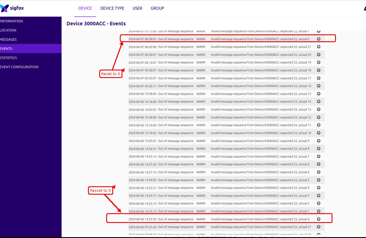

Everything has been working fine except for the problem with the Sigfox uplink (sequence number). The uplink from Sigfox arrives every time we transmit data from the node to the Sigfox backend. However, the sequence number resets to ZERO after reaching 21. It is expected to proceed to 22 but resets to 0 instead.
The message at the Sigfox backend server is:
Invalid message sequence from Device #3000ACC: expected 22, actual 0.
Below is a screenshot of the Sigfox backend server.
I don't know why this happens. If I simply exclude the WMBUS from my code, everything works fine.
I have no idea why this is occurring. Can anybody suggest a solution?

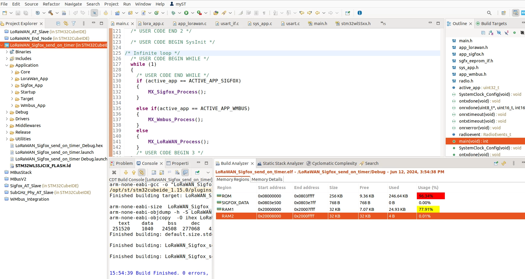

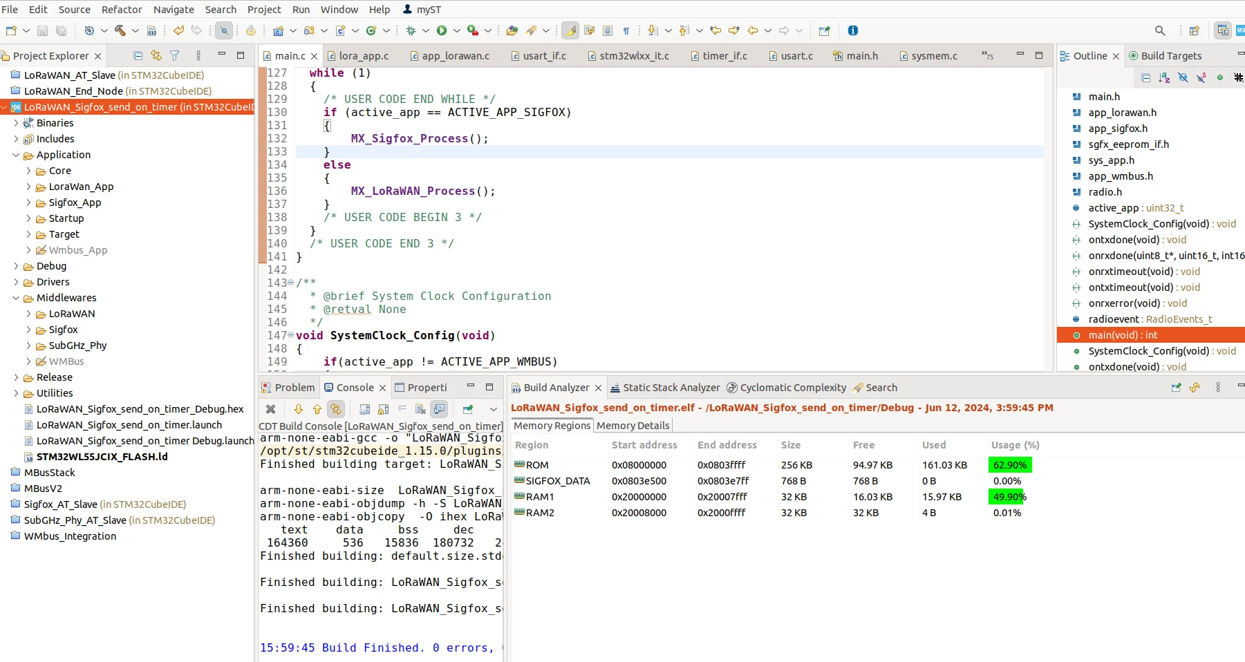

Below are the screen shorts of the memory occupies with WMBUS stack and Without WMBUSTACK.
Memory_without_WMBUSMemory_without_WMBUSMemory_with_WMBUSMemory_with_WMBUS
Is this issue occurs due to the memory occupancy?

Jun 12, 2024 11:19 AM UTC
ROM and SIGFOX_DATA seem to overlap.
Shrink the ROM size allocation in the linker script to accommodate the SIGFOX_DATA, ie 256K - 768B
TakshAuthor
Jun 12, 2024 11:33 AM UTC
Hello @Tesla DeLorean
Thanks for the response.
Below is the memory size allocation used in linker script file by default used. In that the SIGFOX_DATA has been allocated in between the ROM.
Default :
/* Memories definition */
MEMORY
ROM (rx) : ORIGIN = 0x08000000, LENGTH = 256K
SIGFOX_DATA (rx) : ORIGIN = 0x0803E500, LENGTH = 768 /* memory dedicated to User embedded Keys */
RAM1 (xrw) : ORIGIN = 0x20000000, LENGTH = 32K /* Non-backup SRAM1 */
RAM2 (xrw) : ORIGIN = 0x20008000, LENGTH = 32K /* Backup SRAM2 */
I have modified the linker script memory region in which the SIGFOX_DATA has been placed
at the end of ROM.
Below is the modified memory region in linker script file.
MEMORY
ROM (rx) : ORIGIN = 0x08000000, LENGTH = 256K - 768
SIGFOX_DATA (rx) : ORIGIN = 0x08040000 - 768, LENGTH = 768 /* memory dedicated to User embedded Keys */
But the issue still remains the same in sigfox counter(sequence number) has been reseted.
