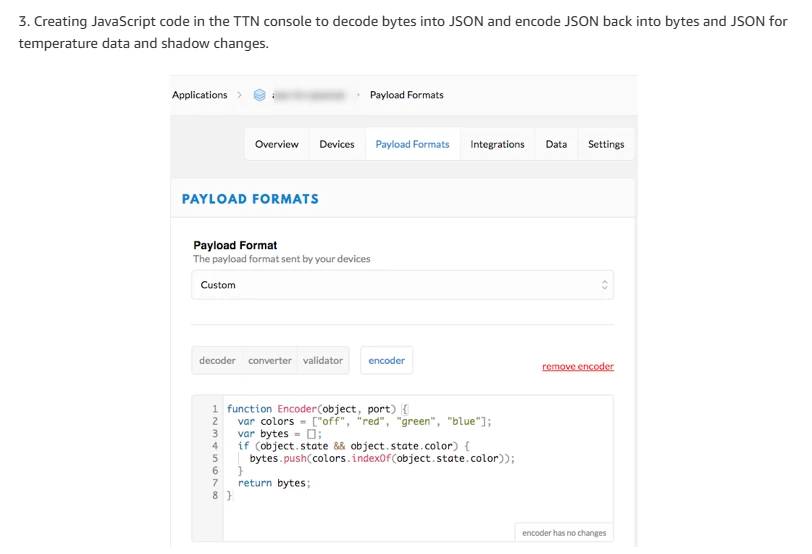

Visitor II
February 10, 2025
Hi @PrathamSalunkhe,
I understand the issue you're facing. I'm also working on some projects related to Class C with the ChirpStack server. When I use the JSON data field for downlink, I have to convert the data from ASCII encoding to a byte array. ChirpStack provides a place to write code for the encode() function for downlink data, so I think you also need to find a similar place to configure the encode() function for JSON data to ensure the device receives the correct data when downlinking.
If you are using the AWS IoT Core application integrated with the TTN server, TTN provides a place where you can modify the decoder() or encoder() functions for the payload using JavaScript.
https://aws.amazon.com/blogs/iot/connect-your-devices-to-aws-iot-using-lorawan/
// Encode encodes the given object into an array of bytes.
// - fPort contains the LoRaWAN fPort number
// - obj is an object, e.g. {"temperature": 22.5}
// - variables contains the device variables e.g. {"calibration": "3.5"} (both the key // value are of type string)
// The function must return an array of bytes, e.g. [225, 230, 255, 0]
function Encode(fPort, obj, variables) {
 var bytes = [];
 // Encode obj values
 var jsonString = JSON.stringify(obj);
 // Encode the entire JSON string including quotes
 for (var i = 0; i < jsonString.length; i++) {
 bytes.push(jsonString.charCodeAt(i)); // ASCII value of each character
 return bytes;
