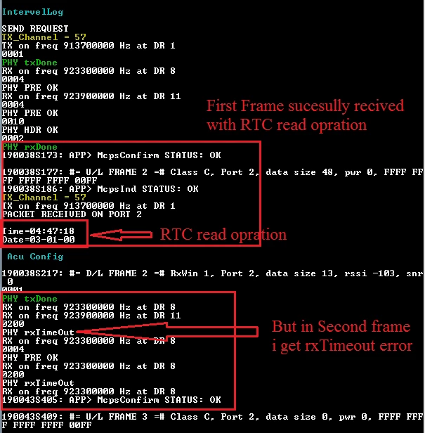

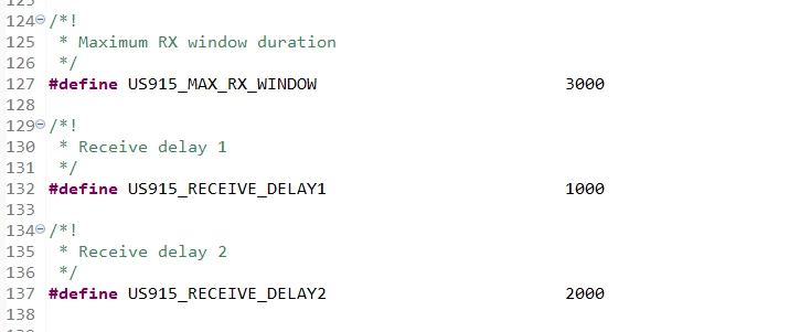

Hello There
I am using stm32L496RG with Sx1262 and I am using SX1262 stack of I-CUBE-LRWAN.
When I try to send multiple data frem to my single node.

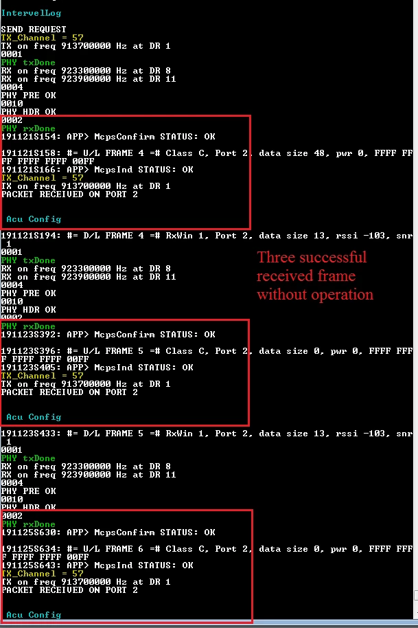

After the first downlink operation, the second downlink is not received and the code generates the "rx TimeOut" Error.
If I will do not perform any operation it works fine.
Is there any way to sync this?
0693W00000QKvaKQAT.pngPlease guide me to solve this problem.
