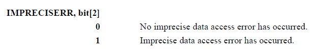

I've done some search regarding the state of the registers in the MCU and I've found out that BFSR.IMPRECISERR register was set.
STM32WL5x_CM4/SCB/CFSR_UFSR_BFSR_MMFSR/MMARVALID:0x0
STM32WL5x_CM4/SCB/CFSR_UFSR_BFSR_MMFSR/IBUSERR:0x0
STM32WL5x_CM4/SCB/CFSR_UFSR_BFSR_MMFSR/PRECISERR:0x0
STM32WL5x_CM4/SCB/CFSR_UFSR_BFSR_MMFSR/IMPRECISERR:0x1
STM32WL5x_CM4/SCB/CFSR_UFSR_BFSR_MMFSR/UNSTKERR:0x0
STM32WL5x_CM4/SCB/CFSR_UFSR_BFSR_MMFSR/STKERR:0x0
STM32WL5x_CM4/SCB/CFSR_UFSR_BFSR_MMFSR/LSPERR:0x0
STM32WL5x_CM4/SCB/CFSR_UFSR_BFSR_MMFSR/BFARVALID:0x0

The dump is next to useless, you want to be looking at the processor registers, and the faulting instructions in that context.
Imprecise implies a write, that was pending in the write buffer, so look a few instructions prior.
Output actionable data..  https://github.com/cturvey/RandomNinjaChef/blob/main/KeilHardFault.c
Failure based on optimization levels tends to high-light latent coding errors.
Watch for stack corruption, or writing variables beyond their scope.
Enable asserts to catch parameter issues.
Find commonality in failures, ie leaving an IRQ/callback for things which are more sporadic and random.
Instrument code to understand dynamic flow, and relationship of things going on, to hard faulting.
