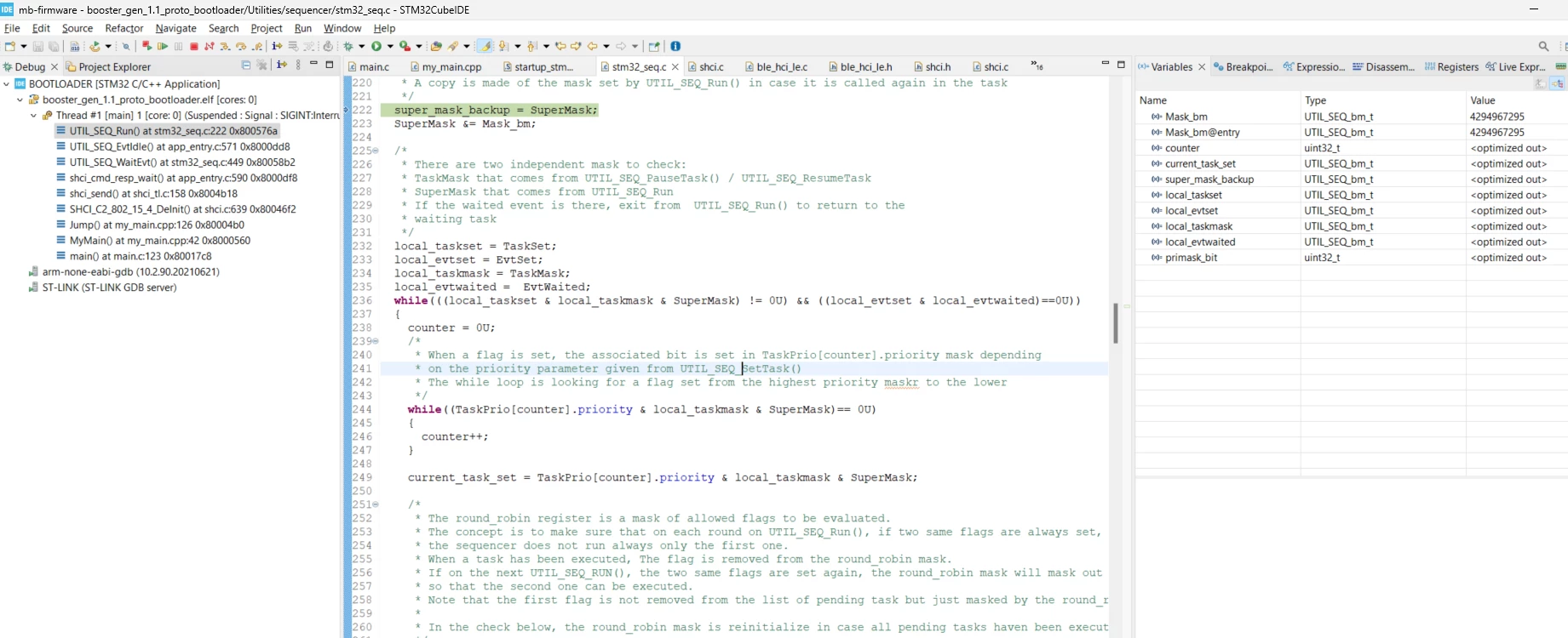

Issue in BLE stack advertisement after jumping with bootloader. Context: We have two binaries: a custom bootloader/ota app and user app with BLE capabilities. After jump from bootloader to app binary, BLE advertisement does not work.

This issue has been resolved by me as follows:
Before jumping:
Pause any tasks registered with sequencer especially CFG_TASK_SYSTEM_HCI_ASYNCH_EVT_ID
Then call SHCI_C2_Reinit()
This will de-init BLE and it can be re-init with different services in other binary smoothly.
 // De-init BLE stack run by CPU 2, this is needed as we are not doing system reset but jumping to another binary and we were sing BLE stack in this binary as well
 UTIL_SEQ_PauseTask(1<< CFG_TASK_SYSTEM_HCI_ASYNCH_EVT_ID); // tell sequencer to pause all registered tasks, in our case advertisement only
 SHCI_CmdStatus_t shci_response = SHCI_C2_Reinit(); // fake reset CPU2 as per AN5289 Application Note "Building wireless applications with STM32WB Series microcontrollers"

0693W00000aISW0QAO.pngDetails:
The bootloader binary has BLE stack initialized with generated code and also user app used BLE stack as well with different GAP profile.
The function APPE_SysUserEvtRx is not called after jump from bootloader to user app binary.
Here is the jump function of bootloader:

The jump is successful if I do not use any commented out shci.h functions but BLE advertisement does not work then in user application binary.
If I use shci.h functions to stop BLE in hopes of stopping the stack to re-init later then that keeps sequencer waiting. Means stuck forever in bootloader.
There is related issue to this but it is unresolved so please help:

The BLE stack works fine only if one of the binary uses it for that binary presently.
